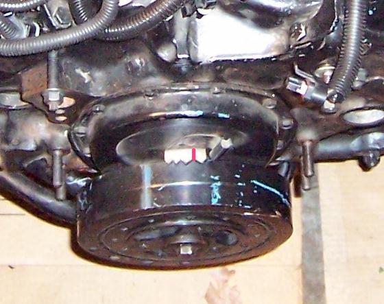

Also make sure that your balancer isn't one that goes with this style of timing pointer:

Im so lost in what to do right now. Its getting me mad. I guess ill try to see if it drives with the timing as is and get it to my friends
