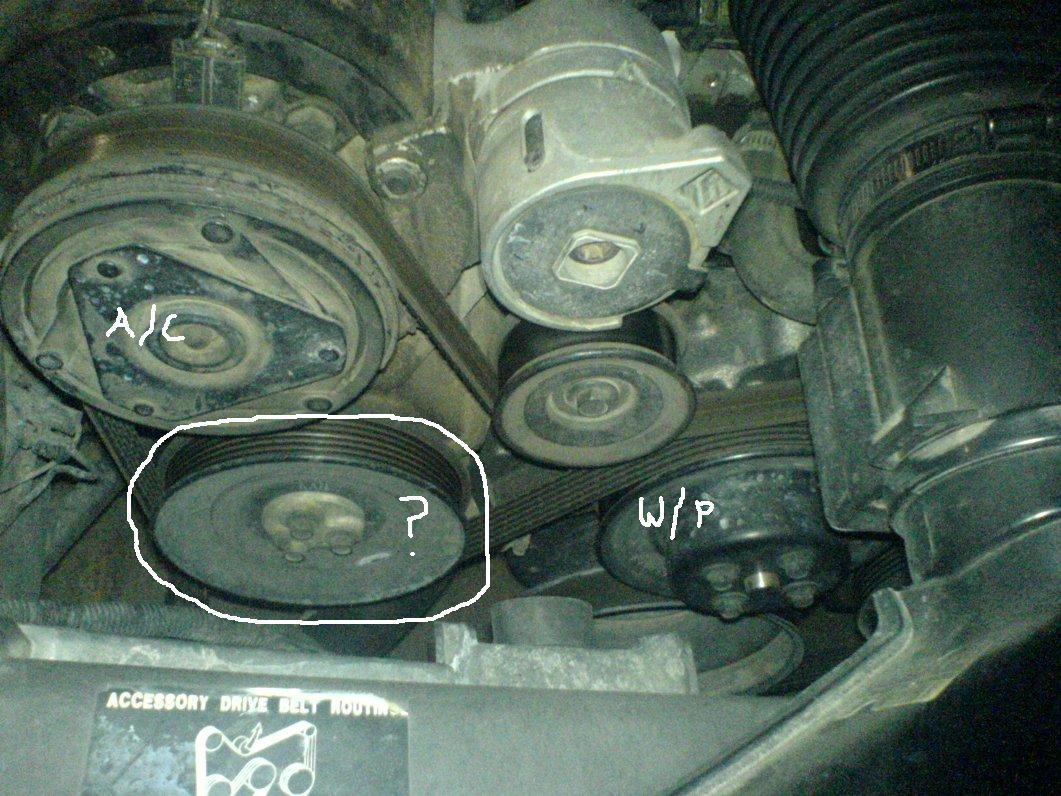

What is this?
Sorry for the small picture, its the only one I could find to illistrate from.
What is this pulley hooked to? I started making an awful grinding scraping noise today for some reason.
I circled it in white.
Old May 2, 2008 | 05:29 PM
Slouch's Avatar
Joined: Apr 2008
Posts: 184
Re: What is this?
Most likely and idler pulley.

Re: What is this?
Well, unless it has a delete pully on there...
It should be your AIR pump, or your emissions system.

Re: What is this?
its the AIR injection pump, part of the Emissions System

Re: What is this?
Originally Posted by Keoman
Reguardless of if I were to delete this, I want to know exactly what it is. Also how to make it stop grinding / scraping / making horrible noises.
This is the picture I just went down and shot, labled as best as I could.
Attachment 156234
That is the pully for the smog pump. The only way to make it stop doing the noise is to replace it, delete it, or even try gutting out the pump.

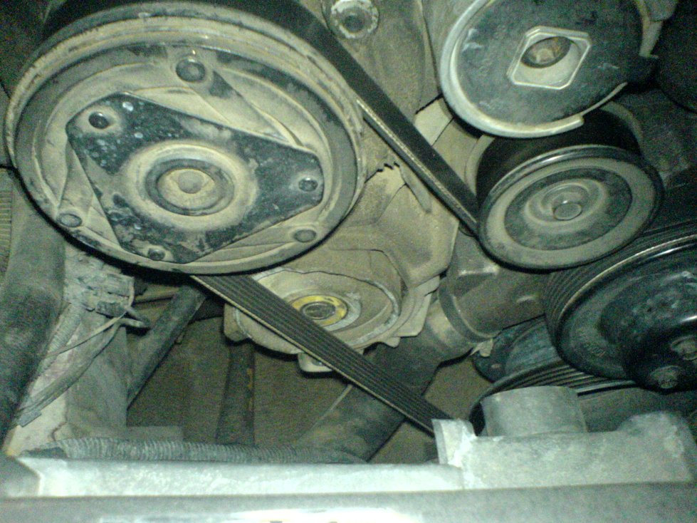

Re: What is this?
So this is my fix to stripped bolts.
Ground away the pump a tad to fit the new belt (yes the serpentine is set up so that it runs right smack dab down the middle of the next pulley)
Car has worked fine so far. No engine lights or change in how it runs. (if there is increased power it's not noticable)
I have a new question, how might I go about getting these bolts out so I can eventually replace the smog pump and get on with life?
From what I remember it is like a 4.5 or 5.5 star wrench size. The insides of the bolt are pretty much gutted, when I do get them loose I will be replacing them with actual bolt heads to avoid this problem in the future.
