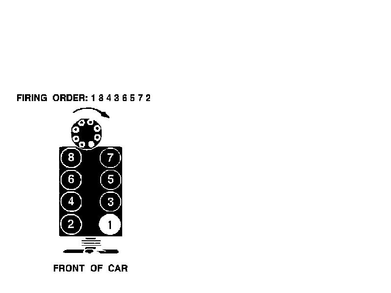

Very simple question
I tried searching but didnt find much but im doing my timing and i thought i knew where the #1 wire was but when i adjusted the timing the car ran like garbage i thnk i may have had it on the wrong wire, if someone can show me where the #1 wire is that would be great. Thanks

Re: Very simple question
number 1 is the front cylinder on the drivers' side
