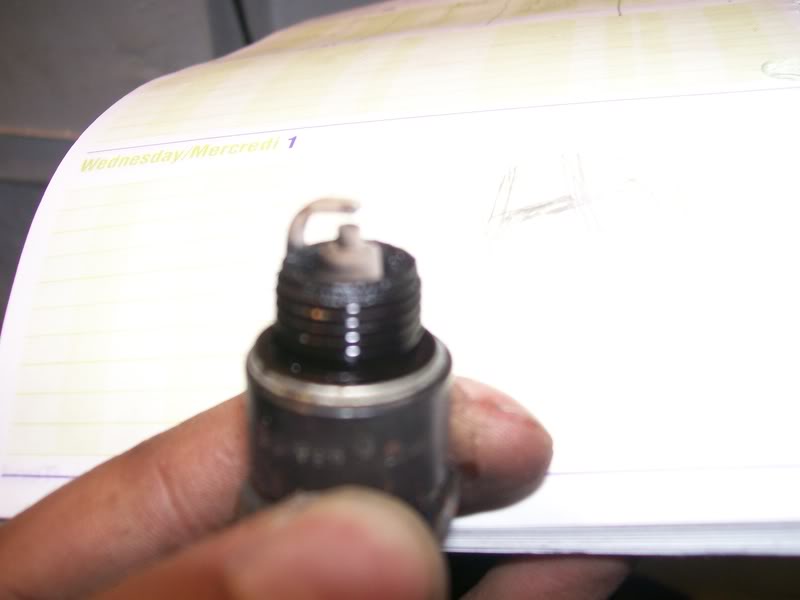

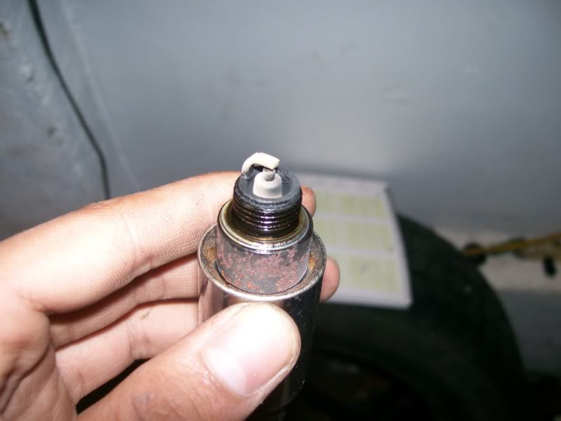

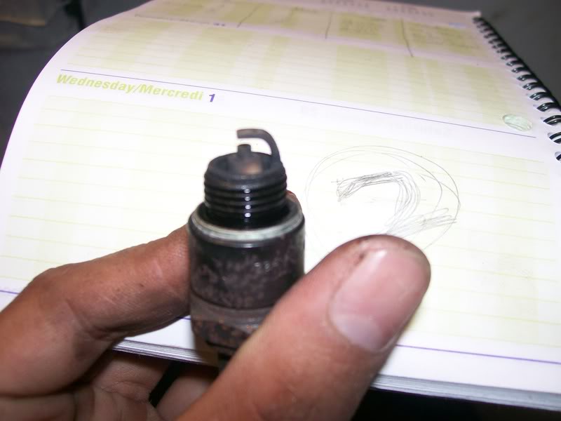

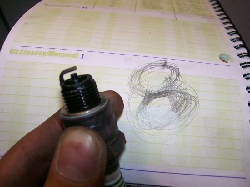

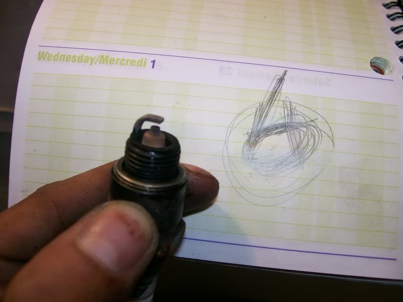

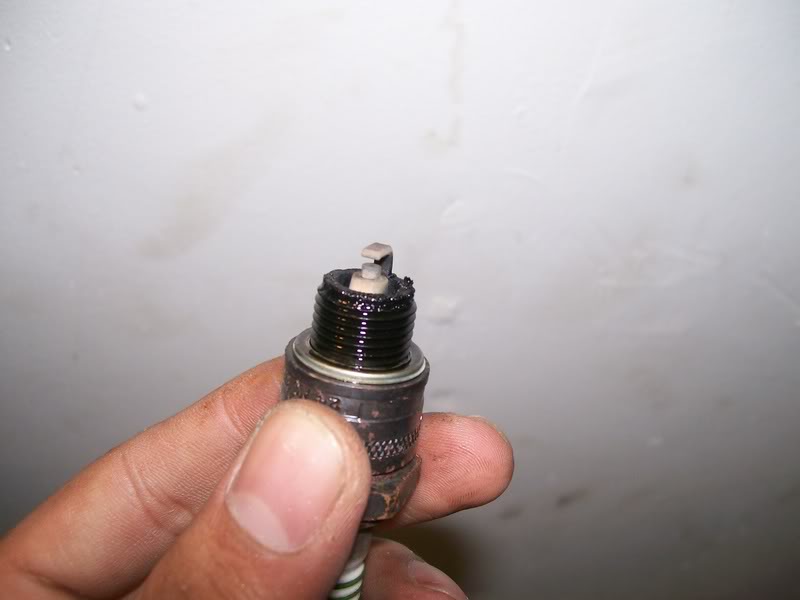

Ok whoever built my headers was clearly thinking of plugs, they did a good job. I was able to just slide the 13/16ths socket on each plug, then i just used an adjustable wrench to break em loose. Worked like a charm. Heres some pix and what i found. My freind has the comp. testor, ill ask him if i can borrow it tommorow.
Heres the result, but for the most part, they looked pretty good.... If not perfect.
PLUG----------->GAP (found)------------>Condition
1--------------->0.043------------------>Sooty everywhere but electrodes
3--------------->0.040------------------>Sooty everywhere but electrodes
7--------------->0.041------------------>Perfect (tan all over, dry)
5--------------->0.041------------------>Sooty everywhere but electrodes
2--------------->0.043------------------>Sooty/ Tan (50/50)
4--------------->0.040------------------>Perfect (tan all over, dry)
6--------------->0.035------------------>Lean? Slightly grey, mostly tan
8--------------->0.043------------------>Sooty, wet with oily residue
Plug 1
Plug 3
Plug 7
Plug 5
Plug 2
Plug 4
Plug 6
Plug 8
All plugs regapped to 0.043 thou.
The "bang" happened aprox. a week ago. The car was doing the whole misfiring thing all week. I played with the vacuum advance a bit on sunday. Drove 30 mins to a freinds house, 30 more mins to the race track. Made 5 WOT passes, drove 30 mins back to freinds, 30 mins back home. Seemed alot smoother on the way back, but still not 100%.
Pix were taken as soon as the plug came out. The "sooty" deposits you see in the pix, smells exactly like the stuff the PCV is supposed to suck up. I was running breathers for a while, so thats probably why. I cleaned them off for now.
