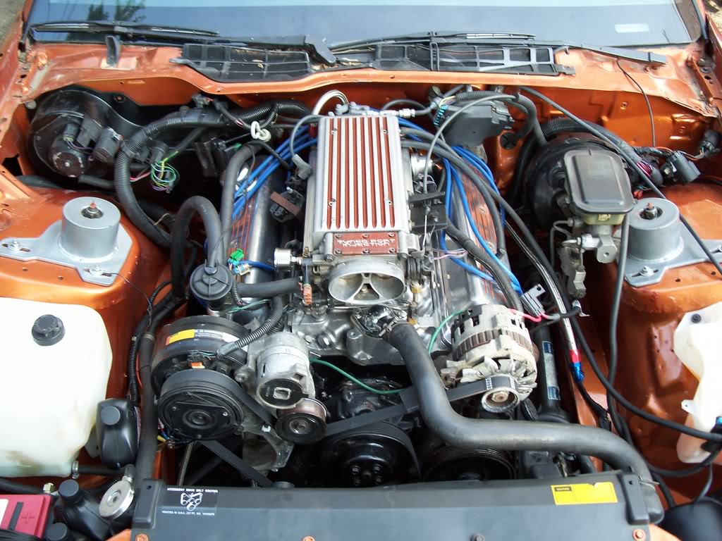

The fuel pressure guage is directly mounted to the rail with a liquid filled one. I thought that the non liquid filled one was on crack so thats why I got the filled one. The FP still bounces arround even with a Snap-On FP guage hooked up to it.
If I remember tomorrow I'll swing by where the car is at and take a quick video of the guage.
Thanks for the ideas!
edit:
You can see where the FP guage is on the fuel rail. right next to pass side of the throttle body.
