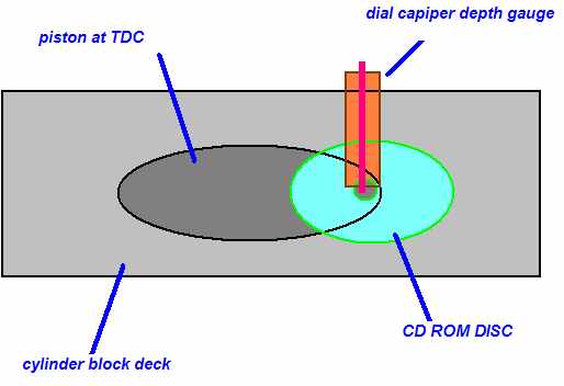

A CD-ROM disc and a dial caliper depth gauge will work.
Subtract the thickness of the CD-ROM disc from the gauge reading.

Thanks all. I will play with my dial caliper a little after I get it at TDC with the Dial Indicator. F'BIRD nice idea and pic
