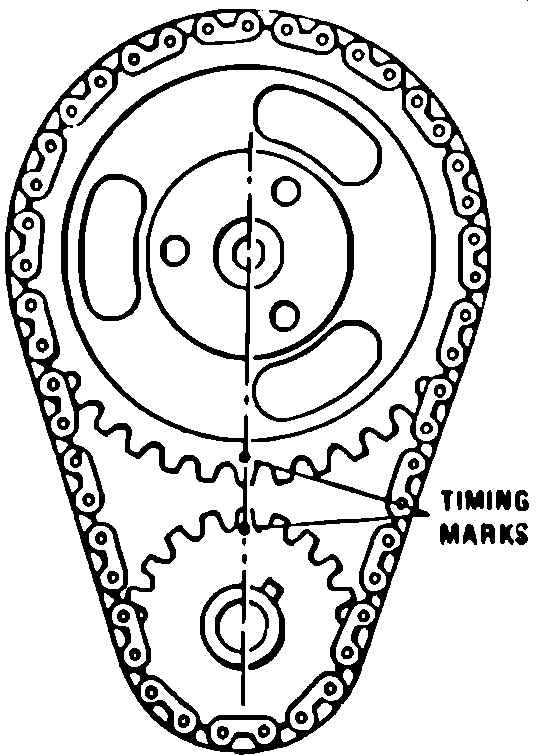

Remove the dizzy cap and #1 plug turn crank by hand in the direction of operation when you feel compression continue turning until the dampner mark aligns with zero on the timing tab, (this is the 12/12 positions) the rotor should be pointing at the #1 terminal if it's not then what was said wasn't what was done.
I've never done 12/12 and I've never had anyone say that's how they did it, that is until now. It's definitely not the method GM uses.
From my AllData for replacing chain, and or sprockets. Here the rotor would be pointing at the #6 terminal.
Turn crank until timing marks on sprockets are in alignment, Fig. 18.
