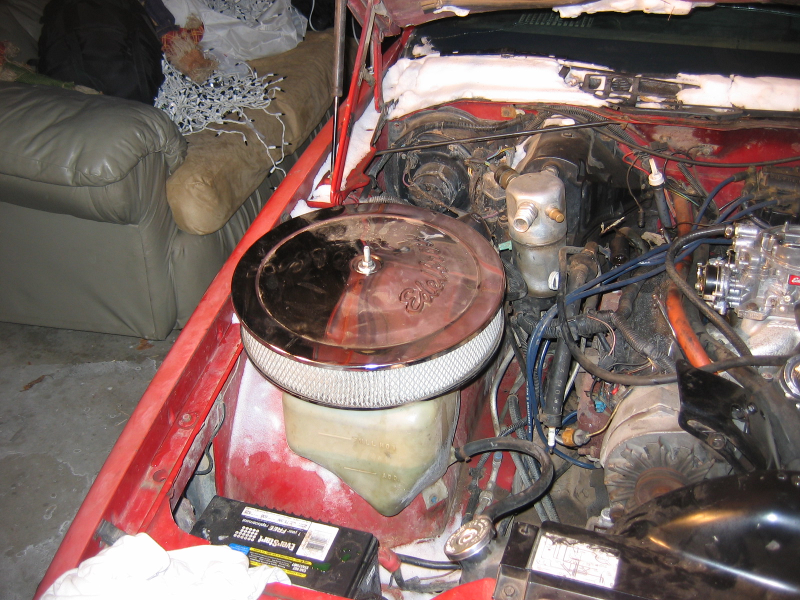

ok.... how do i hook this up to run..
hello every one im the dumb guy who bought a half hooked up camaro with a crap interior thats me yep dumb dumb .... soooooo how or where do i start hooking this motor up to start im a ameture in the engine but im pretty good with electrical and body work right now the engine starts but does not stay running i noticed some coolant on the intake valve cleaned that up and havent done much since the kid i got the camaro from just put a new radiator hose on and that might not be sealed or torqed i know some things but im at a los right now can and will email closer pictures upon request i know for sure the vacum hose's are not all connected and there is a hose on the passenger side valve cover that doesnt go anywhere
please help

Go take a picture overlooking the entire engine bay, standing from the nose of the car.
Edit. PS- I like the spark plug in the A.I.R. hose.

the hose on passenger side valve cover connects to stock air cleanr. you can just use a breather in place of hose.

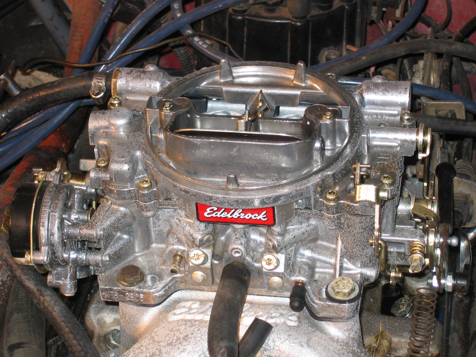

cap your delayed vacuum (left) on front of carb and plug your distributors vacuum advance into the one on (right) also on front of carb.

hopefully these will help will have some overhead pics later
its only 2 below zero outside today my poor garage heater can beraly keep up
Attached Thumbnails ok.... how do i hook this up to run..-img_1838.jpg   ok.... how do i hook this up to run..-img_1839.jpg

what was the engine in the car origionally? was it FI or carb? is there a mechanical fuel pump on the block? passengerside front down low. Is the carb flooding causing it to die?

im not sure what was in it originaly probably a factory 305
not really sure whats in it now add on car said 350 owner of car said 305 father in law says 454 .... trust his judgment but he is not happy that i got another camaro ... wife has a 86 that her mother tboned still getting parts for that.......
here is a pic of the pass front low looks like a new part i figured it was a waterpump but then again i dont know much about motors.... have been studying up though i took the battery out when i first got it cleaned all the oxide off the connections put it back in and it did start up pretty good but i have to feather the gass pedle. started it up about a week ago when it was warmer out to see if it would run on its own and it didnt and since then have had a stron gass oder in my garage so that might be it didnt see any gass leaking but its hard to tell ice is still melting off the car
wont let me upload any more pics....... will email on request or email me thanatos66@hotmail.com
