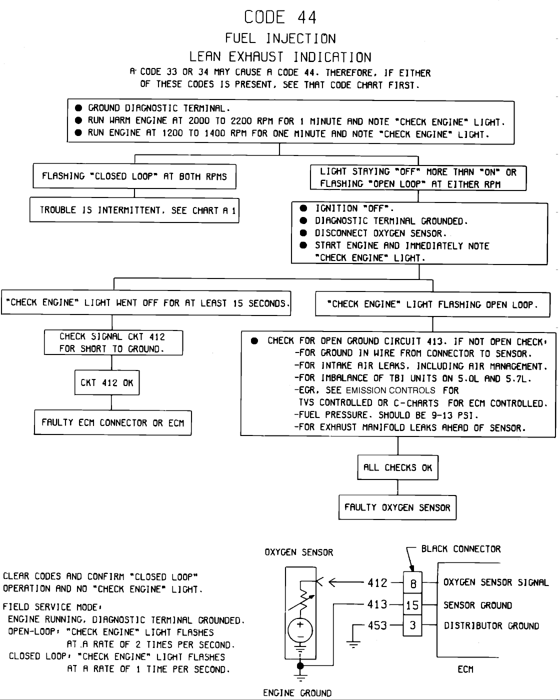

Well the car idles irraticly one day it will idle high and one day it will idle low and unstable. when you drive the car it hesitates and if you floor it itll die out or catch up and haul-A$$
im currently only getting a code 44 and have replaced the oxygen sensor and distributor and coolant temp sensor, I also tested the egr valve and it checked out okay however their was no vacuum from the line going in to the egr valve when i pressure tested it, i used a vacuum diagram and mapped out that i correctly have all the lines in properly and replaced most of them, i did also break the diverter valve and piked one up from the junk yard to replace it, all spark plugs and cables are new as well

If you recently replaced the heads you have to look back at everything that you have done to it. Timing, is a possiblity. With you getting a code 44 and replacing o2, it sounds to me more like a possible vacuum leak or some such issue. You can look around with a can of carb cleaner, spraying around the intake and whatnot, dont get carried away though, you dont need puddles, just some spray. Listen for a change in idle. See attached also:
