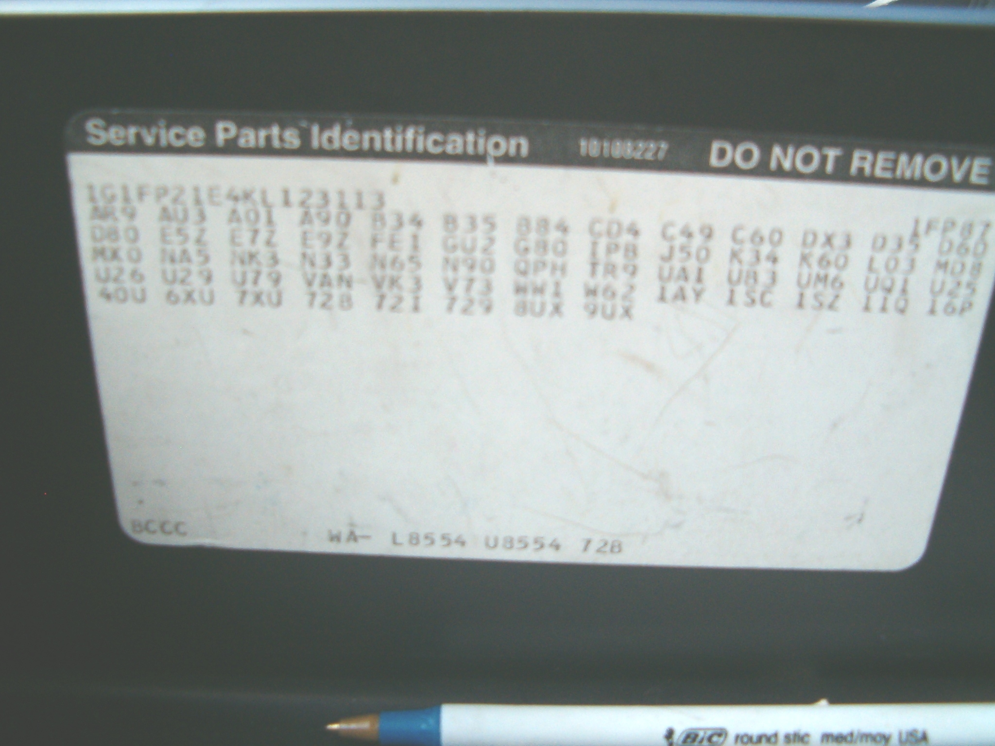

I just looked in the console at the RPO sticker. Is your sticker still there? See how mine has GU2 and then G80 next to it.

Hey rich.. My RPO's only say gu2. no g80. I did not have the rpo's in my console, but I had the chevy dealer print out mine using my vin. I am gonna have to check by way of lifting one tire and see if it spins i guess. Maybe they screwed up (GM) and did not put the g80 on mine. I have an 86 IROC also, and it doesn't have the rpo's for posi, but it has it. My mechanic told me it has posi. I know it has 323's due to the way it revs at 70. I don't know the history of the iroc, but either GM missed something, or one of the previous owners switched it out. My rpo code in the iroc is gu2 which is 273 open..

Yep, GU2 is 2.73 ratio. As for the posi, I verified it is a posi when I had it jacked up (to remove the gas tank) and both wheels spin together. On yours, someone probably switched out the open end.
