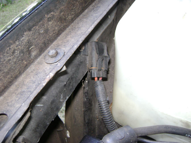

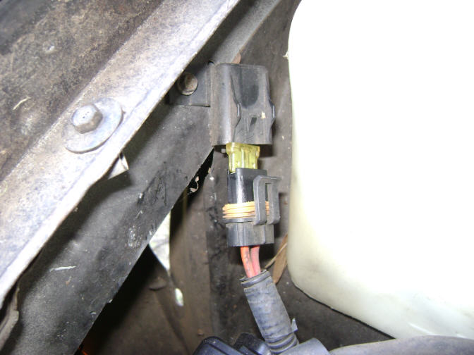

you know I had the same problem, is the car running at all? if the fuel pump isn't kicking on then look under the hood at the battery there is some wires that goes into a socket looking thing and clips in there (atleast on my 89 camaro) and if you unclip it and pull it out there is a fuse in there and its probably blown. I had the same problem and couldn't get it to read any codes or anything either until I changed that fuse. I have added pictures to show what i am referring to

89, you couldn't get it to read any codes, because that fuse
is the constant power source to the ECM.
Without it, zip-zero-nada!!

if it has a computer in it and its a third generation Camaro then I believe it has that fuse but if its running then its not blown. Not sure what you are looking for, if its running fine and the light isn't on then its not going to read anything but 12. If its running fine and the light won't even flash 12 then the light may be burnt out, try changing it
