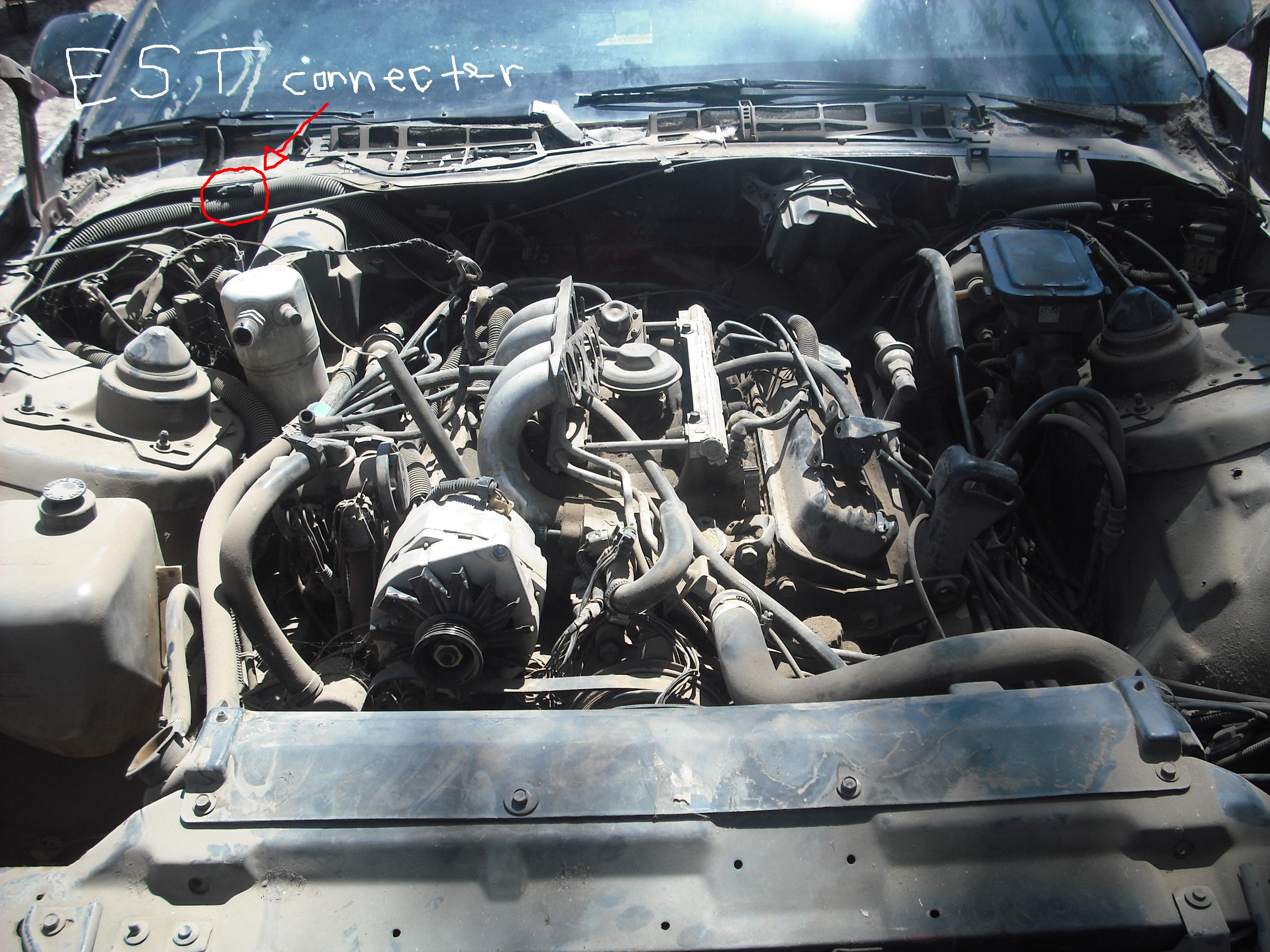

my 86 IROC-Z EST connector is here on my picture below.
found the connector coming out of distibutor,set my base timing,pluged est back in,then checked timing with est connected,the timing is still at the same spot,that is not right,right?
