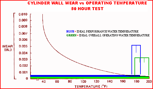

Cool is good to a point, but be aware that engines running 160 or less will wear out the cylinders and rings much sooner. Look at the chart and you can see why automakers use 195 deg. stats.

50 hour test. I doubt my engine runs that much in 4 years.

That trend will also probably fail to continue. It should reach a point where wear tapers off as the "newness" of the motor is removed and the parts wear in to one another.
