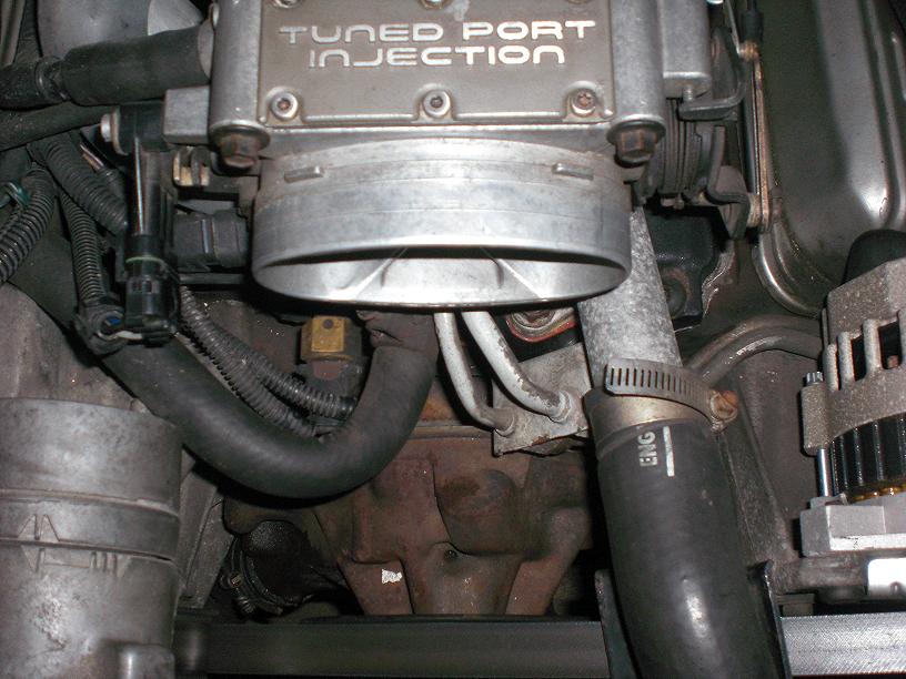

this is where its supposed to be right?
Old Sep 21, 2009 | 08:24 PM
trueburton's Avatar
Joined: Mar 2003
Posts: 522
From: Michigan
Car: '88 Red Trans Am w/ T-tops
Re: How do i adjust the timing when...
sorry about that....
no, you're still looking in the traditional location. It's not at the 2:30 position, where you're looking, it's at the 12:00 position. When I said down, I meant down from directly above.

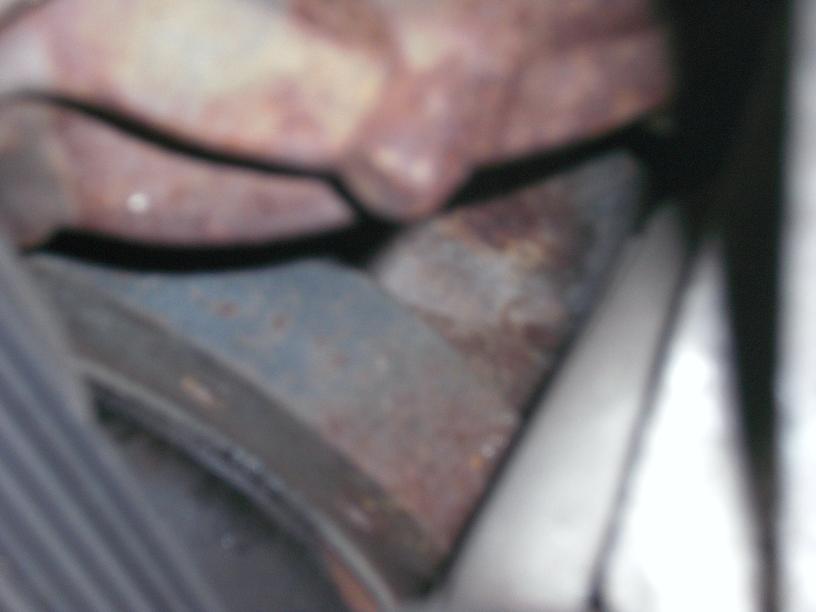

how am i supposed to get to 12:00 when the water pump blocks that off? i looked as best i can and found no tab at 12:00. thanks for your advice
see?

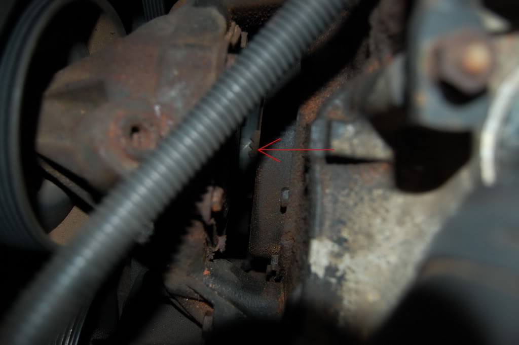

The timing tab "should" be behind the water pump as said, I think it's more like the 1 O'clock position standing at the front of the engine, and it's not easy to get a timing light in there, I have to stand on my toes and reach over to get to it, but if it's really not there you can put a timing tab ANYWHERE you want to as long as you locate the exact TDC of #1 cylinder by using a piston stop or some other device and then making a new TDC mark on the balancer that lines up with the 0 on the tab. Here is a pic of my engine showing the timing tab with the red arrow pointing to it, excuse the 200,000 miles of grease!!!
On my TPI i have coolant lines and sensors, not to mention the 4" air intake that are all in the way. Plus i did crawl under the car and got my hand up where you show the tab and there is definately not a tab there. I think i will have to make a new mark on my balancer thanks for the help.
