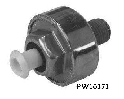

Is the knock sensor to the left of the oil filter? I see where a plug suppose to go, but there's no plug....and there are two wires hanging down that are cut. If that is the location of the knock sensor, than whoever installed the gear drive removed the knock sensor.

The knock sensor is on the passenger side of the block just above the oil pan. Should have a single wire.

Knock sensor looks like this and it can be on any side. usually is on passenger side when it leaves the factory. And like the gentleman above said, yes its only one wire.
