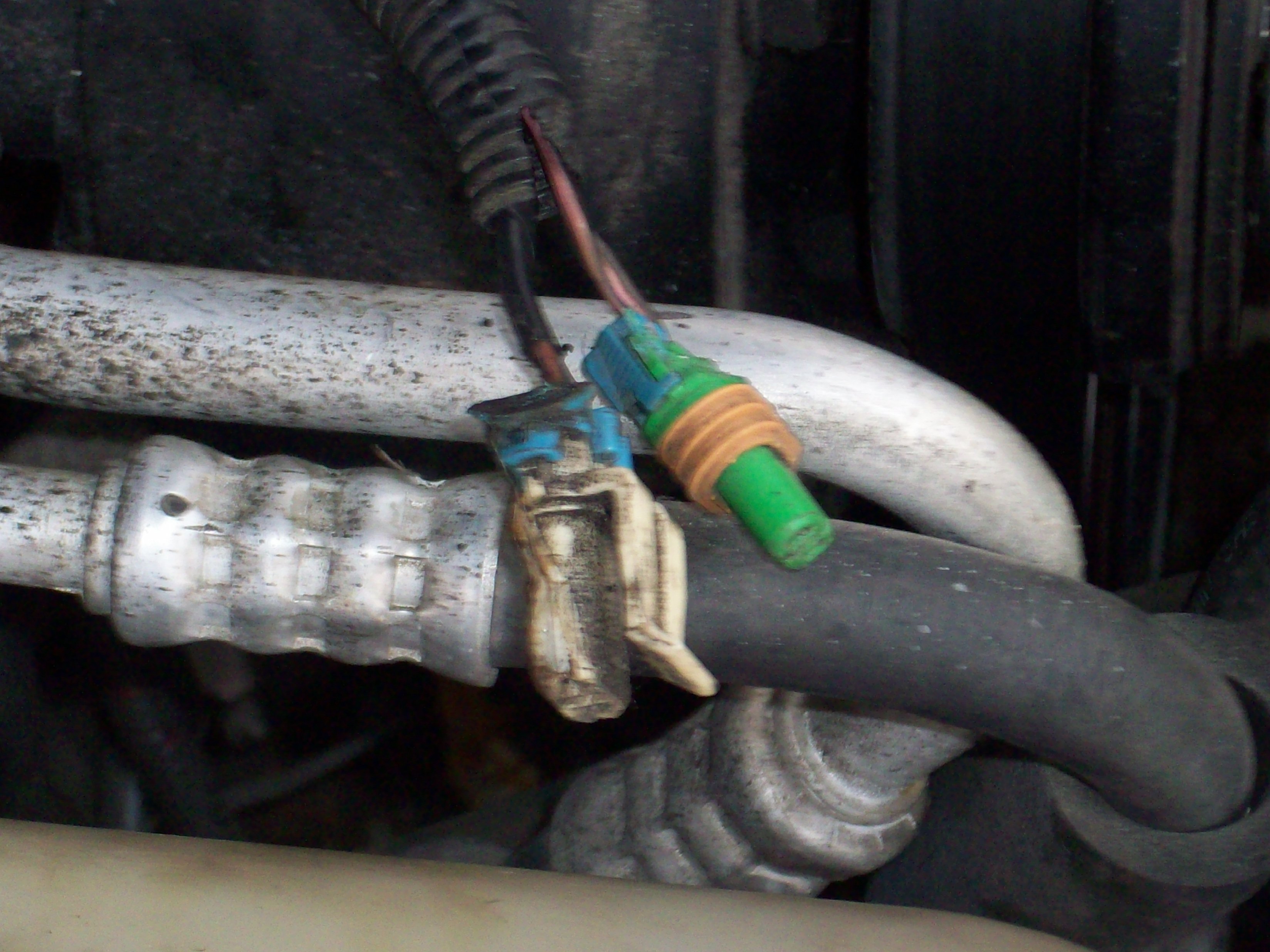

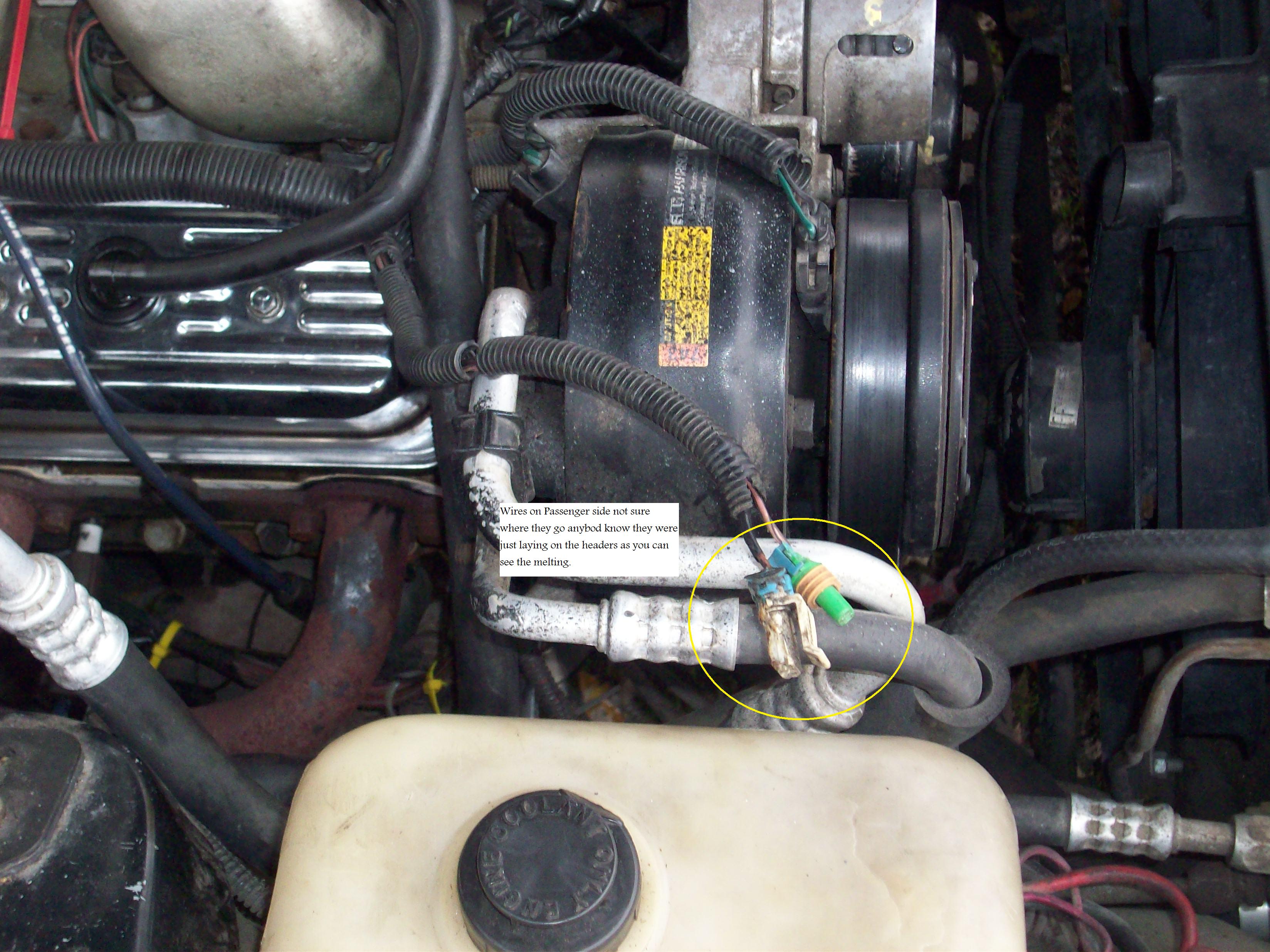

Ok heres some pics the engine bay is kind of a mess right now but i did the best i could with the pics. There is two plugs that i found on the passenger side laying on the header i dont know what they go too

The temp sensor is in the front side of the intake, close to the timing cover and water pump. That hole you pointed out is just a extra hole or something. And those other connectors are probably for the smog diverter valve.

Wow thanks, good idea on posting the pics, so i will go look for the real temp sensor. But any other ideas why it might be runnin rich and surging at idle, maybee bad o2. there is no cat on the car so i thought it would be pointless to change the 02. am i right or not. And do i need that smog diverter valve that you were talking about.

Hey dude, that hole is not for your temp sensor. Like the other guy said , your CTS is on the front of the block under the throttlebody. It should have two wires coming out of it . One is yellow and the other one is black. As for that other set of wires in your pic. I will check my car again and see if they look familiar. They should be hooked up whatever they are.

All those lines do is open and close a valve for the smog pump. You don't even have the smog stuff to hook up. In your picture it looked like you had headers. If so then your smog tubes are gone, their on the stock exhaust manifolds. Is the smog pump underneath the ac compressor? or is it gone? That stuff does not effect the way it runs without it hooked up.

the threaded hole is for a different application, on corvettes there's a cable gutter that runs there to hold the injector harness
Here you can see the square black gutters on the inside, between runner elbows and valve cover
the 2 connects are both for the AIR switching valves (black box above manifolds, removed on yours hence then being loose) They are behind the little cover on the assembly (whole thing missing on yours)
