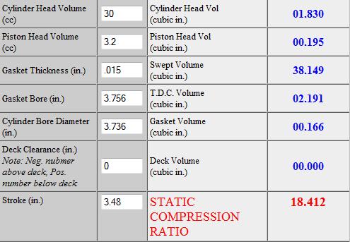

Right bud, 13:1 is quite achievable with the TFS heads (and to prevent further argument from you, the RHS 200 cc runner heads with 50cc chambers would be fine, just drop the lift a bit because of the small bore and proportionally large volume runners for the engine, and I'd be set) and a bit of milling along with forged flat-tops or slightly domed pistons, and since you're the apparent know-it-all; I assume you know the amount of horsepower a stock assembly can take. Please, enlighten me. It's actually more an issue of piston speed, for your information. By the way, it'd take 50cc chambers to run 13:1. Did I not mention that I was just around 12.5:1 at the moment? You aren't aware of my intentions with the engine, but I'll fill you in before you continue running your mouth off. My intentions were achieving better efficiency while gaining high torque throughout street usable RPMs, rather than throwing in a 383 and ruining my fuel economy. Maybe I should throw in a RamJet 502? Or maybe could stick with the 305 and ditch the parts that make it crappy? Also, I don't recall mentioning cost or horsepower anywhere in the thread. Hm, spend $3500 on heads, rods, pistons, and intake manifold that achieve what I'm going for, OR **** away 5 grand into an engine that's not what I'm looking for. You tell me, Sonix. For what it's worth, I give you props, you're a better man than I, with all the research you've done on the topic; I mean really, you must have strained yourself... sticking your arm so far up to pull those numbers out of your ***; I couldn't have done it better myself. My BSFC, VE, TE (which just about offsets your advantage in cubes) are all far better than yours. I'm sure my performance is as well, anything else, sir?
PS: Your whole paragraph looked like a typo.
Can the stock rotating assembly support 13-14:1 CR with forged flat top pistons?-getoffmythreadsmartass.jpg
Attachment 187566
Can the stock rotating assembly support 13-14:1 CR with forged flat top pistons?-cr2.jpg
To everyone else, thank you for the input.

Okay, but running a supercharger at 8psi with 9:1 SCR is equal to running with just about 14:1 CR, 13.9 if you want to be precise... That's far from unheard of, no? That's when an intercooler comes into play. However, instead of running 14:1 TCR with a blower; I'm opting to run 14:1 with a 70 water/30 methanol. How is this any different? A high SCR is far more efficient than running with a typical roots/carb blower setup.. Hell, it's still more efficient than running a centrifugal. The engine will draw in the air it needs from vacuum alone rather than having a belt driven SC blow it. Like a supercharger, you'll still have high velocity exhaust, hence the much longer duration on the exhaust side while minimizing overlap, or creating negative valve overlap (EGR essentially). Both the 14:1 TCR SC engine and 14:1 N/A will put out the same amount of pressure,heat, and torque; the only difference is that N/A is more efficient. They can both run with low lift in street RPMs, which is why a lot of people just bolt on superchargers without changing cams, although this will choke the motor above 5k, but who drives that on the street? Well aside from being more efficient, the N/A will require the water/meth injection to prevent detonation, along with the knock sensor.
TCR formula is as follows by the way:
(Boost (psi) / 14.7) + 1) x SCR

I think your getting confused with how boost works. Boost can be thought of as a displacement adder. IOW, the blower, turbo, or what have you will take in more air than the engine could ingest on its own. The ammount of power that can be developed by an engine is essentially a function of its thermal efficiency and quantity of air/fuel taken into the cylinder. A 14:1 dynamic CR NA engine will NOT make the same ammount of torque (and hence, power) as an engine running boost and making an apparent dynamic CR of 14:1. Dont fall into that trap. The two systems are not equivelent. The reason being is that the NA engine has a lower mass of air in the cylinder. Under ideal conditions it may be efficient, but it will make less power than an engine under boost. CR is not a replacement for boost.

a blower at 8psi is putting an EXTRA 8 psi of air into the cylinder.
do some math and that gives a ratio of about 1.5 under OPTIMAL CONDITIONS
meaning that at 100% volumetric efficiency, there is 1.5 times the ammount of air in the cylinder than would be there if the engine ingested it on its own.
typically VE for a engine is around 72-76% on a mostly stock engine.
this means that only 72-76% of the air that SHOULD be in the engine actually is...
thats why superchargers were invented
the original idea for superchargers was to add air into airplane engines during combat.
at high altitudes, the supercharger would be switched on and voila, more power.
so you can see that a supercharger is really just a VE modifier, it makes the engine feel bigger than it is.
back to reality, your high CR engine will have nowhere near the power of a engine with an 8psi blower.
say you start with 9.5:1 CR and you increase it to 14:1
you increased your CR by 38%, but you will not see a 38% increase in power.
you will be lucky to see 5%
as everyone has said, there is an optimal point based on what engine characteristics you start with
14:1 is not optimal unless you are running race gas of some kind
