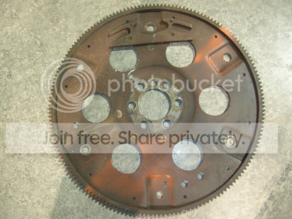

So i have a factory 350 flexplate layin in the shop, i can buy one of those wieghts and mount the two together behind my stroker motor, retain the starter i have and be done with it?

Should be able to, as long as your torque converter bolts to it and starter mates with it. Is it 153 or 168 tooth?

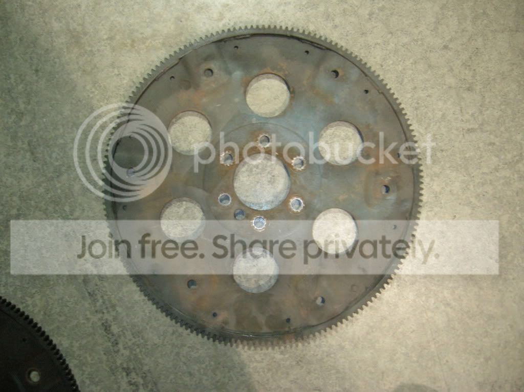

I believe it is a 153 tooth, it came on a stock 350 block that i was going to rebuild. I have a starter to match it like i said as well.

Trucks typically had 168 tooth flexplates, for what that's worth.

So is there a difference between the 168 and 153 tooth other than the starter?
I guess im gunna have to go out and start counting

Just meaure flexplate
168 is 14" dia ; 153 is 12 1/2"

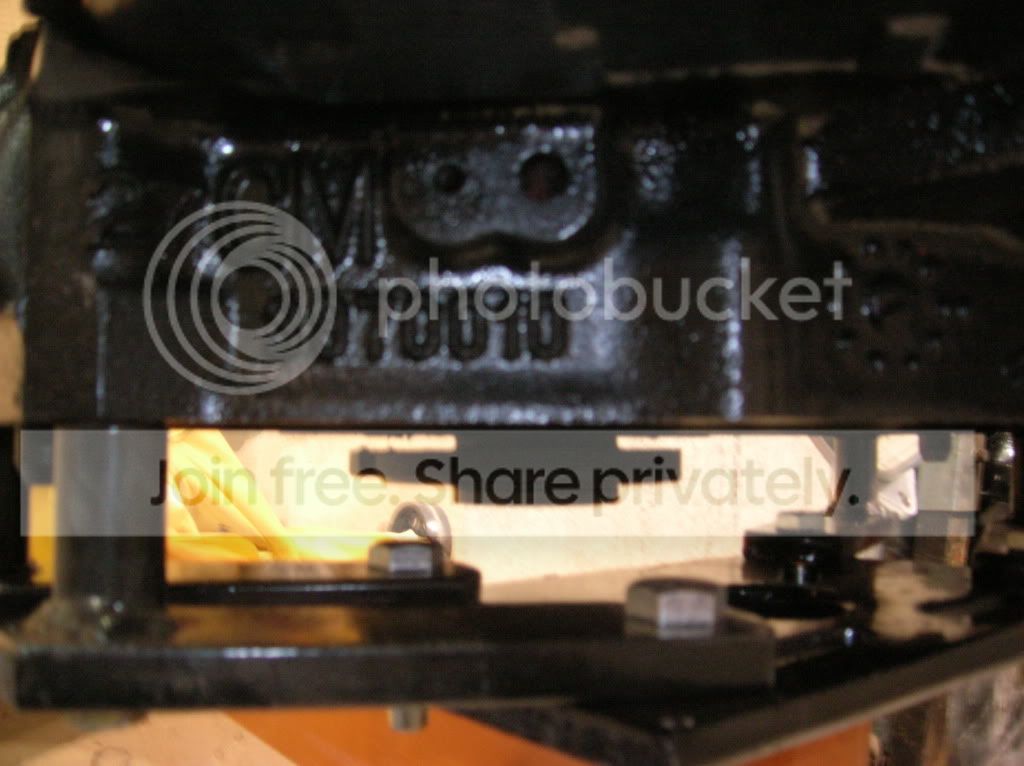

I dont know the year of the block, I can provide the casting numbers if that helps...
And I also dont know if its a 1 piece rms or 2 piece...

Ill run out in the shop and get the casting numbers and post those up asap as well, thanks for the help, and keep it coming :]

Well I went down in the shop last night and took some pictures of what I got, im not exaclty sure of what they are tho...
This is a weighted flexplate that I got from a buddy. Its 14 inches wide with a 2 inch center hole.

This is a non weighted flexplate that I took off of a project 350 motor I had. It too is 14 inches wide but it has a 2 1/2 inch center hole.
The top one is externally balanced and the bottom is neutral balanced.
You have a 69-72 chevy 350 block according to the casting number so you then have a 2 piece rear main seal so you then need a internal balanced (neutral balanced) flywheel/flexplate.
The top one is off a late model 1 piece RMS engine; ext balance at REAR only / neutral at front .
Note smaller PCD of crank bolt pattern compared to early model 2 pce seal one at bottom
Not if he has a 400 stroker crank as noted above.
Needs correct 400 only flexplate
