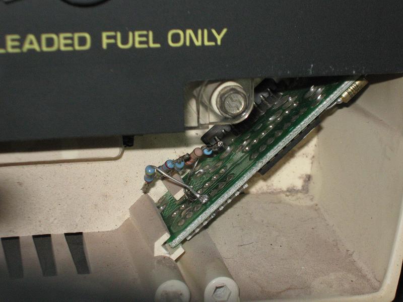

All you have to do is to unsolder the connections for the 2 pins and get it to 198k ohms or as close as possible. That is the way mine was done and it worked out great. If you know someone who works in maintenance maybe they can for it for free. That's how I got mine fixed. We looked and the closest we could get it was using the 5 in this pick.
