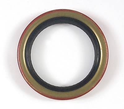

Does anyone have any opinion on the Timken or Mr. Gasket timing cover seal that goes where the harmonic balancer is?
I just didn't know if one brand seal was better than the other? I do know the Felpro timing cover gasket set also comes with the seal. But it is the same price. So, it makes me wonder how good the seal is with the kit if it is the same price as a Timken or Mr. Gasket seal by itself.

Bump. Anyone know the correct timing cover seal? They list different ones at Autozone and Advance. I'm thinking of going with the Timken or I may get the Felpro timing cover gasket kit that comes with the seal. But I wonder how good the seal is in that kit since it is the same price as just a seal alone.

Bump. I've gotta buy this timing cover seal soon. Just needing to know which one to get.
Mr. Gasket:
Timken:

I decided I'm just gonna replace the seal. I kinda wonder if it could be the harmonic balancer as I replaced that over a year ago. So maybe it could have been cheap and got a groove worn in it already. I think I got it at Damperdoc or something.
But anyways, I know of that Felpro kit. But the thing is that entire Felpro kit is $8 and it includes the seal. But if you buy a Timken or Mr. Gasket seal, that is $8 or so just for the seal.
So, I'm thinking the Felpro kit has cheap stuff in it as I don't see how a timing cover kit with seal could cost the same as the seal alone. I just don't want to do this again.
Felpro timing cover kit with seal. $8.39:
Timken seal. $8.99:
I think the Mr. Gasket seal is something like $10.

I'll probably go with the Timken seal as it should be better since it is the same price as the Felpro timing cover gasket kit that includes a seal. So something has to be cheaper in the Felpro kit for it to cost the same as the seal alone.
