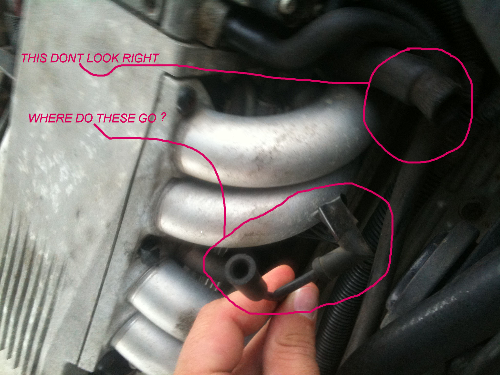

Anybody care to fill me in on what the lines are in the pic and have any idea why they are disconnected , engine is running,... but its hard to say wether its idling right or what not as it has a header leak I need to fix anyway.

Second pic is heater diverter valve - when heat controls are in cool setting, this valve is closed which keeps hot coolant from entering the heater core - when you change to warm settings vacuum is sent opening this valve allowing hot coolant to circulate through heater core.

In the first photo... The disconnected large hose goes to the diverter valve in the second picture, which appears to be broken. The little hose in the first picture looks to be the hose that goes from the MAP sensor to... I forget, a check valve maybe. That is a vaccuum hose. The MAP sensor is just to the left of your hand/runners in the first photo. It should connect underneath the sensor somewhere. A picture or 3 of that area could better show me what's going on over there and see if you even have the check valve and other hoses still.
By the looks of things, it looks like someone has bypassed some stuff. The heater valve in general is a piece of garbage, but I do like to keep mine in working condition. It looks like the hose heading out towards the front goes... somewhere. So at the least, the coolant bypass under the throttle body has been bypassed. That valve just looks weird on the side with no hose. Like a piece is missing or melted or something. Oh, I see now, it's that sticker I get on all my replacements. Nevermind, prolly functioning perfectly. But the disconnected hose in the first picture originally went to the valve where the long hose at the top of the picture now is. Since it's bypassed, I wouldn't worry about it. To the best of my knowledge, it's designed to help heat the water up when its cold out by running it to a plate under and attached to the throttle body.
In the first photo... I'd guess that piece fell off. I'd also guess that the tap on one end was to try and seal off the hose and prevent vacuum leaks. Without a good look at that area, including where the EGR valve is underneath the rear of the plenum, I couldn't tell you if its just broken or disconnected. But at a minimum, if that hose was taped to prevent a vacuum leak, reconnecting it and properly sealing it could straighten out your idle.

Thanks everyone ,
Im gonna take some more pics for you, I think I know where you need to see and maybe I can get them hooked back up and sealed. Planning on buying an assembly manual but just got her dropped off 2 days ago. Like i said there's a header leak and the trannys 3-4 pack is shot so she aint goin' nowhere for awhile, Degreased the engine area when I was taken those pics so I can see leaks if any I plan on workin on the engine while I save to get the tranny rebuilt.Again thanks I'll post some more pics when I get off work.

Ok got my shop manual and have pretty much deduced that the shorter hose that orginates from what I think is the solinoid goes to the EGR valve as it doesnt have its vacum line connected. The hose is the taped off one with an L shaped end or "fitting" if you will. Im pretty sure this is it it just looks awkward like that.Anybody know if this is right? The other Line is still a mystery it comes up through the firewall and is bundled with the A/C wiring harnes it looks like.Narrowed it down to A/C, or cruise control as the Cruise vacume line looks kinda wonky as campared to the manual.

There is a vacuum line that goes to the AC controls in the car. Maybe that's it? Also, if the EGR valve doesn't have a vacuum line going to it anymore, the valve is nonfunctional as it needs that vacuum line to open and close the valve. If I read what you said right... Dunno if that valve being disconnected is intentional or not. I suppose you could replace the EGR valve and reconnect the line to it. Replacing the valve would just be a good idea being that it has been disconnected, may have had a problem to warrant it being disconnected in the first place and its just, well, old. It's always a pain trying to figure out why a previous owner bypassed or disconnected something and whether you should fix what they did or not.
