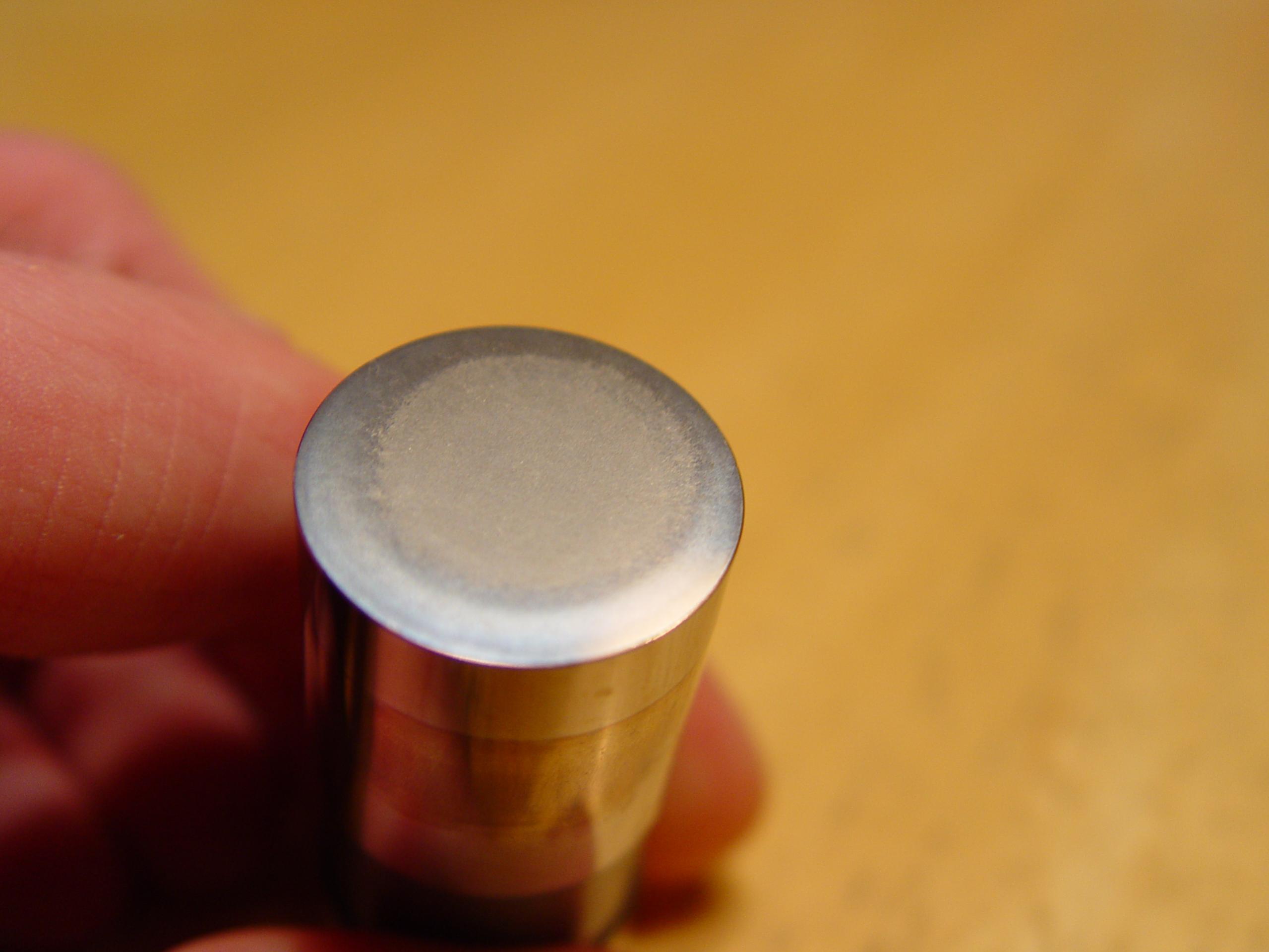

Heres what they look like. The surface in the center has a dull appearance. Not the usual shiny surface good lifters would have. The crown is also missing. It looks like it was in the very first stage of failure.
It would be nice to know what the answer is. If I had waited a year, I probably would have a much more conclusive (and unwelcome) answer, but I cant tell a whole lot at this stage.

I decided to crank up the zoom on my camera to 200x to see what the surface looks like
Looks like its pitted and flaking. My guess would be that the metal was simply overloaded beyond what it could take (maybe poor heat treatment, or just not strong enough).
I really hope the next set works better. Im really tired of ripping this motor back apart to fix stuff...

That last picture was from a digital camera? I really have to get with the times!
Did you use liberal amounts of assembly lube on all the lifters?
Regardless of the issue, it looks like the lifters took the bulk of wear, and not the cam. Always a plus.
Edit: Just realized you said you inspected them after break in with no issues. Bad lifters have my vote.
I took it by using a cheap microscope and putting the camera (Sony w/ Carl Zeiss lenses) up to the eyepiece. Surpisingly, it actually still can focus through the optics. My father has a freestanding microscope with a digital CCD in his office, but thats too far away just for a pic.
Yeah, it looks like they couldnt take teh load. These where generics repackaged from isky. I think many other companies use them as well.
