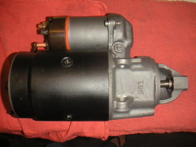

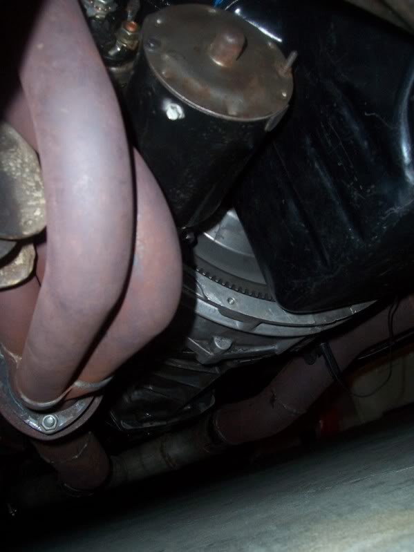

Old Jun 30, 2010 | 10:10 PM
vetteoz's Avatar
iTrader: (13)
Joined: Apr 2005
Posts: 7,736
Likes: 14
From: Not in Kansas anymore
Car: 82 Z28
Engine: 383 SP EFI/ 4150 TB
Transmission: T400
Axle/Gears: QP 9" 3.73
Re: Headers = Starter failures?
Originally Posted by dustpusher
vetteoz was that bolt in and go or did you have to modify anything?
Have to change mounting bolts to suit ( shorter ) and possible changes to main battery cable depending where yours is now
1/3 weight of old style Delco shown.
You will really appreciate it if you have been lying on your back under car holding old starter up with two hands while trying to get a bolt started with your 3rd

  #46
InfernalVortex's Avatar
Joined: Dec 2005
Posts: 6,499
Likes: 31
From: Macon, GA
Car: 1992 Camaro RS
Axle/Gears: 9-bolt 3.70
Originally Posted by vetteoz
Don't know whether it is the position or construction of the Denso but you seldom see guys on the C4 Vette forums with starter problem like you do here on 3rd Gen unless they are worn out .Many running headers and no reports of heat soak with the Denso
Just for clarity, I will point out I never had problems with my 305 (I had the same exhaust with my 305 for a while as I got the 350 ready to swap in). It was only when I put some serious iron under the hood that the starter started having heatsoak issues. A little higher compression too.
My remote solenoid did help, but not very much. I was really disappointed with it.
