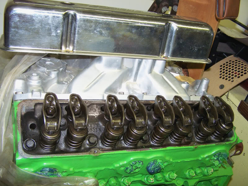

I made another posting asking about the heads. But I was offered this block for $500. It's a Goodwrench over the counter crate 350 from what I understand. Nothing special about it. Nothing internal done. Believe it's a '86 block. Doesn't come with a balancer, any pulleys, no intake or distributor, headers, blah blah. Basically I have EVERYTHING I'd need to get it going, except for a harmonic balancer. Engine is said to have less than 20k miles.
Anyway, you guys think it's worth $500?

I wouldn't pay that unless I could pull both heads, the oil pan, and check ALL the bearings. As in, remove ALL the caps. If everything checks out, then it's a good deal. The intake manifold is crap and only worth the scrap value of aluminum.
I wouldn't bother pulling the timing cover, because I'd buy a new cam and timing set to go along with my head porting and better valves.

Went to check it out and end of the day bought it. The block is definitely low mileage, and was definitely kept up with. Almost still looks brand new. I told the guy to keep the intake. I have a Holley of my own that I plan to use.
I don't have any future plans to make this into a beast or power hog or anything. I was solely looking for something to pick up, throw mt bolt-ons on, and cruise.
So for the price I think I did pretty good, got a engine stand as well

You might want to use the advice about checking that Atilla gave. I bought one with low miles, clean, ext. Ran it about 3 months without checking anything upfront. Then it smoked like a smog truck, Bad valve guides. But I would not listen to advice given to me,, I hope you do.

Bought it, and opened up the oil pan. Found a broken piston skirt and metal shavings EVERYWHERE. The guy was clueless. He knew what was up with that thing. And not only that he tried to sell it after the fact to a buddy of mine.
It's a shame how shady people are these days.
On the UP side, bought a 87 non-roller 357 complete for $450. Got it down to the block and it definitely needed head gaskets. It had steel ones but it sat for about a year so gaskets are due now anyway. Engine turns over fine, heads look good, block looks fresh. Lets see where this one takes me.
