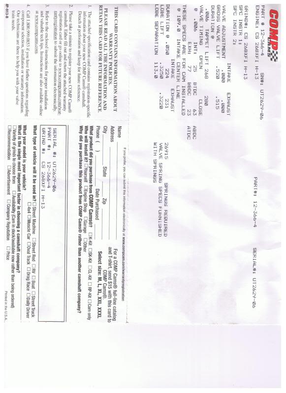

I am still learnign so bare with me.
I am going to replace the timing chain while I have it out so I have a few questions.
My cam gear has 2 sprockets so does that mean I need a Street true roller timing chain; Double roller?
http://www.autozone.com/autozone/par...3_9993_0_58670
Also I'm putting this cam in (Its a flat tappet where as the timing chain says its a true roller timing chain would that effect it?):
EDIT: Would this timing chain work?
http://www.summitracing.com/parts/CCA-3030/

You don't want just the chain, you want the whole set. Cheaper that way anyway. Look; http://www.summitracing.com/parts/CLO-C-3023X/
