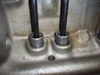

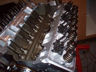

Re: serious engine assembly issues
Old Sep 4, 2010 | 11:54 AM

so ive got conflicting opinions here, every guy at my speed shop says thats "incorrect" to clean up theyre laugage. the main question posed being how a roller cam fit in(not being a retrofit cam) when it doesnt have the provisions for roller lifters.

Why wouldn't it fit? It's identical to a retro-roller cam, except for the nose.
Old Sep 4, 2010 | 04:42 PM
Posts: 28,025
Likes: 2,496
Sounds like you need to quit listening to the guys at the "speed" shop, and let them stick their heads back up wherever they normally them and go back to putting fart pipes on Honduhs and 30" wheels on Escalades.
There is no difference whatsoever in how a roller cam "fits" the block. The journals are the same diameter and in the same places, the lobes are in the same places, etc. You can stick a factory-roller cam in ANY block. The timing set however, is a different story: the cam sprocket for the factory-roller setup is expecting a retainer plate that's about .080" or so thick, and if that's not there, the cam will go into the block too far by that much. Plus, there will be no retainer if there's not a retainer (duh), which means that you have to do 2 things: make a spacer to take up the space that the retainer otherwise would take up (easiest to do by just getting a retainer and grinding the ears off), and using a cam button to keep the cam in. Only problem with that is, the bolt pattern in the factory-roller cam nose is MUCH smaller than the pattern in a real roller cam nose, which doesn't leave enough room for a cam button to fit down in there. But you should be able to whittle one of the nylon ones down enough to where it will fit among the 3 bolts.
If your block has the bolt hole bosses and the holes to accommodate the retainer plate, then you could just use that and be done with it.
Then of course, use the original style roller lifters, with the link bars joining adjacent lifters together.
