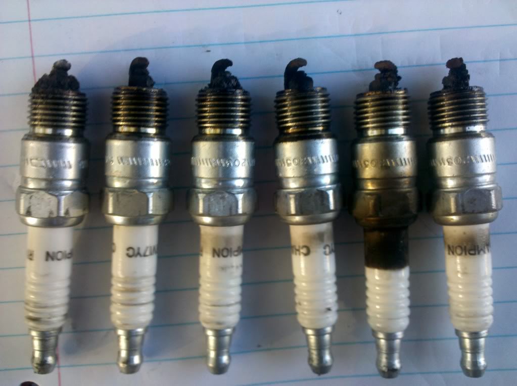

I was checking compression to figure out why my #8 cylinder keeps fouling out and dieing. Pics are below of what I found. One plug (not #8) looked like the end was a booger made of carbon- I had to knock some off to make sure it still had the ground strap.
Most of the buildup was on one side of each plug. I recently ran Seafoam through, and finally got the carb dialed in.
Any ideas what would cause this kind of buildup? The stars by the cylinders are the ones I replaced with some Accel plugs I had laying around (I only had 6, and no time to go to Advance).

Im sure you know that buildup is ash deposits from burning oil. The only two ways oil can enter a cylinder is through the rings or through the valve stem seals. Generally, only a small amount gets through the stem seals. The heavy buildup you have would tend to indicate poor ring seal. You might try Rislone or Marvels Mystery Oil to see if you can clean up the rings and get them working again. If not, it may be overhaul time. Of course youll send the heads out for service as part of your overhaul.

Sorry bro. That is oil ash. Fuel fouling doesnt leave those "flags" on the ground electrode. Only oil does that. If this is a recent rebuild, Im going to speculate that the rings never seated properly. Rislone or Marvel's may help that, along with a ring seating exercise. You add 1 quart of either product with an oil change, run it 3,000mi then repeat.
The trouble is, your recently rebuilt motor shouldn't have alot of build up. The Seafoam should have cleaned the upper cylinders. How is your PCV system? You need to have something in place to relieve crankcase pressure or youll get oil past the rings. Also, they do look rich. Hows your ignition KV? You may want to check it. Might need to address a weak ignition(coil, dist). High output motors need higher spark energy to fire the denser mixtures and fire consistantly in the higher cylinder pressures they develop. MSD is popular with racers because the multiple spark discharge helps provide more complete combustion in these high stress situations.
Ring seating goes like this: Find a long, steep hill where you can drive slowly. Climb the hill in second gear, keeping RPM around 1,500 - 2,000. Turn around and decend the hill the same way letting the engine hold vehicle speed. If second gear doesn't hold it well enough, use first gear. The idea here is to push and pull the engine. Press and pull on the rings to get them working. Repeat this process several times. Do this only after adding the oil additive. Be sure that you perform this process using dinosaur oil, not synthetic. If the problem is not solved by the steps explained here, you will need to re-ring the motor with a fresh crosshatch and start over.
Just so you know, I do this with every new motor I build. Its the only way to assure ring break in. I run 30 weight oil in my new motors for the first 1000mi, then I switch them to 15-50 Mobil1. Once they go on synthetic, the ring break in stops. The synthetic oil doesnt allow the friction needed to seat rings. Therefore this break in process has to be performed properly. Otherwise the engine will always use oil and the plugs will look like yours do. Its especially bad when I use low tension rings(1/16"). They tend to blow by anyway.
Your solution lies somewhere between ring seal, crankcase ventilation, and ignition system. Take a close look at each. I hate to even say this but are you sure you installed the rings correctly? Did you align the compression ring gaps with the wrist pin, the oil ring gaps at 90degrees, centered on the wrist pin? Did you get them in right side up?

Rings are probably fine.
More likely, it needs valve guide seals. VERY common, almost inevitable even, on SBCs of all ages and sizes.
Nothing you pour in the crankcase is going to make any difference to that.

Do you have access to a flexible borescope? If so, pull off the carb or TB and snake that thing down the intake so you can see the backside of the intake valves. If it's got carbon built up on it 1/8"+ thick then most of the oil is coming past the valve seals (possibly made worse if the valve guides themselves are badly worn). If the backs of the intake valves are fairly clean then the oil is coming past the rings.
If you see the BG44K ad at the bottom of this thread, take a look at the "dirty" side of the valve in the picture. That's MILD oil caking compared to what can happen if the guides/seals are badly shot.
Also, plugs that have deposits mostly on one side of the plug indicates the oil is coming in through the intake valve (the dirty side will point directly at the intake valve for the cylinder it was installed in). Oil coating the plug threads is also more of an indication of oil coming in the intake, less an indication of it coming past the rings.
Your comment about not knowing if you had the rings installed in the proper orientation (up vs. down) is troubling. Get it wrong and it'll burn plenty of oil. The 2nd compression ring acts at least 50% as an oil scraper. Get the top ring wrong and it won't seal in combustion compression worth a lick (lots of blow-by that your PCV valve can be picking up).

Although I doubt it's your problem due to the fact that it's occuring in more than one or two cylinders, oil does have a third possible entry point: internal vacuum leak through the intake manifold gasket(s). When that happens it pulls oil from the lifter valley into the respective intake port(s) and gives the exact syptoms you are experiencing.

Following up with this. Just pulled the engine 2 weeks ago- replaced the oil pump with a M155 and Canton bolton pickup, New Canton oil pan, Fel Pro offset rear main (knock on wood no more leaks this time YAY!!!), and now I'm doing the valve seals. Using the blue Fel Pro positive seals that I talked about a few posts up.
My question now- is there some trick to locking them onto the head- some crimp tool, etc? I used a hose clamp to try and clamp it down and get the metal collars tight, which makes them hold the boss better, but without doing that, they pull up with a decent amount of force.
Or am I over analyzing and just push them on (using the provided valve sleeve/protector of course) and just leave them?
Re: Pulled plugs, Checked Compression- need your opinion!
so you're finally taking the steps to address the problem and you aren't bringing the heads to a shop for new guides and seats???????????
yes, a valve job might be as high as $300 for both heads but isn't it worth it since you have them off?

The heads are NOT off- I just pulled the engine to make life easier doing the oil pan, pump and RMS.
Also, valves and guides are fresh from machine shop in '07, and have just a few thousand on them.
if the engine is out, it's just some head gaskets and an intake gasket. I'd yank the heads so I could inspect them and at least lap the valves.

Already finished up on the bottom end. Just doing this while it's out and I don't have to stoop over the car and shell out my knee and lower back (lowered Camaro's aren't the greatest for the back!).
Don't take this the wrong way, but I honestly have no desire (or time and budget for gaskets, head bolts, machine work) to lap the valves or tear it down that far- I have a 350 that I've been allocating for, so the next time the 305 is out that will go in. Then I'll budget for going through the heads again if I re-use them. Just doing some cheap fixes.
I also find it hard to believe that in less than 4 years and 3-4k, the new guides and new Manley Race Flo valves are shot. Umbrella seals, though, the 1st one looked chewed up.

I put an engine together.
GREAT care in making it ALL blue print, and CLEAN.
Had a "friend" drop it in for me.
Three miles later, ( count 'em THREE ) got smoke, oil out the dipstick, and other nasties.
Found 1/2 teaspoon of loose rust in the oil pan.
Total tear-down time.
Infant mortality should tell you something.
I'd pull the heads while it's out, and look.

My 84 T/A is also doing the same with the plug. Other than changing the plugs upon feeling a loss of power due to plug fouling up is there any way to temporarily address the issue?

Ended up being the intake gasket. The center bolts lost torque, but I replaced the gaskets as well as the valve seals too.
