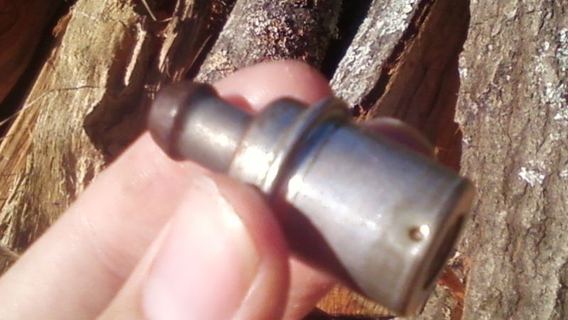

this is my pcv valve right? isnt it supposed to have a hose running from it to the carb?
im just wondering, because this is how it was setup by the PO
one valve cover has a plastic tube running into it with a hose attached from it to the carb, air travels both ways through it
the other valve cover has the pcv valve in it, with nothing attached, air only travels one way
im just trying to make sure it isnt backwards, but to me it seems like it is
excuse me for my ignorance, lol

i did what you said, but as soon as i pull the hose off of the passenger side valve cover the engine bogs out and dies, according to the "emission hose routing" sticker, its suppose to let air in, if all its supposed to do is let in fresh air why is it dying? i dont know whats going on there, this sort of thing makes me think its hooked up backwards or something
and the pcv feels like its sucking air in, i thought it let air out... i dont know
heres a pic of where it hooks into the carb, it looks like its supposed to be this way, but yall probably know better
and where it goes into the base of the carb

That looks like the PCV valve in the passenger side. What's in the driver side?

the hose on the passenger side valve cover is straight through, i can blow through it both ways, the drivers side has the pcv, but i can feel air sucking in through it, not a lot of air, but it is sucking air
when i took the pcv out i could blow through the bottom of it, but not through the top where a hose is supposed to connect to, so it must be pulling air extremely hard into the passenger valve cover
the engine still runs perfect, doesnt run hot or anything, stays at about 190 once warm, so i can still drive, its just one of those things that bothers me

PCV valves operate on vacuum, it should have vacuum on the top side of it provided to it by a vacuum hose that routes to the intake system somewhere(I do not know where for your specific engine, the engine should not be sucking air into the crankcase through the pcv valve, the pcv valve is for venting crankcase pressure caused by blowby, when combustion gases slip by the piston rings, which happens to some extent even if everything is in good order, so basically, when you're looking at the PCV valve as it is installed, the airflow should be coming out of it, not going into it, imo change the valve, its like $3 and quite possibly part of your problem, also, make sure the top of it is connected to intake vacuum. The other valve cover is going to have something a little different, generally its a hose that connects it to the intake system directly, and prevacuum, as it feeds air into the intake, basically its there because there is no vacuum at wot making the pcv valve ineffective at full throttle, so its a secondary thing to do the same thing more or less, but it also has an effect on idle and such....hope all that helps...

Your pic shows clearly what's wrong.
As I explained above, the PCV is supposed to draw vapors into the intake, to keep the oil clean. The fitting on the base of the carb that you have hooked up to the pass side VC, should go to the PCV valve which is in the driver's side VC.
THe fitting in the pass side VC should go to an air filter of some sort, usually that extra little one in the side of your main air cleaner assembly, to allow filtered "make-up" air into the crankcase, to replace the METERED amount that the PCV valve takes out.
With yours hooked up like it is, you're putting hard manifold vaccum on the crankcase, without the metering efect of the PCV valve. That's why it has suction in it.
Get you the little filter, put it in your breather, hook it up right, it will behave much better.
