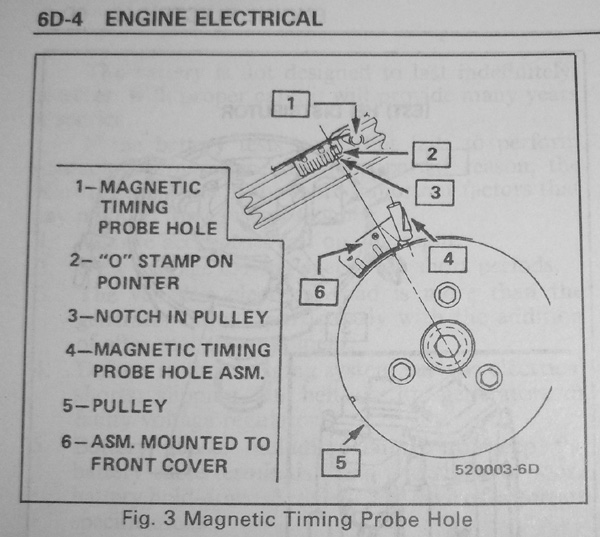

I replaced the spark plug wires, spark plugs, rotor, distributor and the coil for safe measures. Runs a little better but still, When I take off, there is still hesitation and a little backfire. I know everything was running fine, before I parked it and it sat for some time. I would fire it time to time and it would fire up with no problem and idle great. I took it to the garage and they did replace the mass air flow sensor, which made it run better alot. Exactly, where is the timing mark suppose to be and a pic would help. They set it right under the tube pretruding from the timing mark plate. The throttle body shaft you are talking about, is located and again, a pic would help. I am old school mechanic lol. Something is off somewhere and it is small thing and I am going nuts all over again. Please help guys and Thanks

This is from the 85 manual (the huge official one). Looks like zero is the deepest notch not the hole.

I used the timing light and the mark on the damper is right underneath the probe hole. Is this correct? I thought it was more over to the left of probe hole. One more thing, Could a throttle position sensor cause hesitation and backfiring on acceleration, if it is not working properly? and if so, what is the correct postion should the sensor be in, because I could never figure that out lol. Thanks
