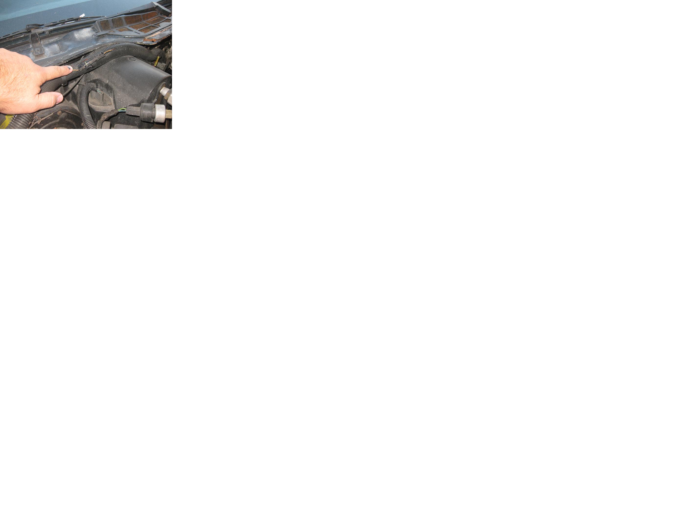

im still messing with the timing on my 87 iroc camaro, i have the est wire disconnected. i start the car and it somewhat runs choppy so i have my timing light on it and when i start to get it to 0 degrees and start advancing it to 6 the motor starts rasing alil bit on the rpms but the motor starts making poping noises and like you can feel it if you put your hand on the motor. i just dont know what it is but if i go to like retard it and drop it down before 0 deg it stops but then it idles really low then just shuts off. any ideas on what it could be

Don't mean to be repetitive, but it sounds like you may not be disconecting the EST wire, maybe something else? I'm attaching a couple of pics of the EST wire and where it is located inside the plastic wire organizer that passes over the heater box. Are you sure you're following the steps explained on the https://www.thirdgen.org/settingtiming technical article? I'm not trying to insult your intelligence, I'm just trying to help, maybe you're doing something wrong?
i understand and thanks for you help. i did look at the article but i think i might not be gettiing right on tdc. i mean i put my finger in the hole in the number cyl and i turn the motor until i feel air pushing my finger then i just line the mark on my balancer up and then i take the cap off and line the rotor up close to the number one cyl then i fire the car and it starts and yea i have the est wire off now and when i start to advance to 0 and move up to 6deg it starts making a poping noise but when i hit the throttle it souneds heathly what am i doing wrong. i love the car but its just making me mad and i dont wanna sell it over something this stupid
