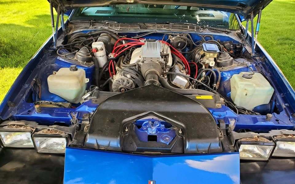

I am looking at an 86' Iroc Z-28 with 41,000 miles. The previous owner upgraded the 305 with a crate 350 and dual exhaust. It still retains the stock look under the hood with tpi, does this hurt the value or increase the value?
Thanks,
Tim
Thanks,
Tim
Value to who? I would rather have the 350, because I don't care about originality. For someone who does care about the car being original it would probably decrease the value.
If you are looking for an "investment" I would recommend a SP500 index fund.

I can't imagine anyone would pay more for an engine swapped vehicle over an unmolested example all else being equal. Also just on that engine picture it looks to have a case of previousowneritus so I personally I would be looking for a decent discount over similar comps.
Depends on the 350. There's some REAL CRAP out there in the "rebuilt" aka "crate" world. Some, I'd rather have the original 305, than those. Some real gems too. It all depends on the details.
I'd have to see this "dual exhaust". Since no such thing ever came from the factory, only a single exh w 2 tailpipes, it's not an easy task AT ALL. Again, there's some REAL CRAP out there in this realm, and some real works of art. Details matter GREATLY.
Overall a fairly nice looking car, from what can be seen in the photos, except that they hacked the AC off of it. I believe I'd have to lose the tire slime and the mud flaps myself, though.
I doubt the "value" is affected much by whether it has a 305 or 350, regardless. What "value" these cars has, is in their CONDTION. A TPI 305 in GOOD condition is better than a 350 straight out of a 76 Impala with150k miles and a fresh coat of Krylon on it for example. None of them are anywhere near "fast" by today's standards, unless AHELLUVALOTTA money and work has been put into them, first among which is getting rid of the TPI. (was great in its first coupla years, rapidly got outclassed, and nowadays is hopeless) "Originality" isn't worth much except that many "mods" that have been popular to do to these cars over the nearly 40 yrs since that one was built are raw unadulterated unvarnished unmitigated unalloyed ELEPHANT PLOP; the less of THAT that a car has, the better. Tastefully done, functionally sound, true IMPROVEMENTS, can help; better disc brakes than the crap they were putting on 86 cars, for example. That one looks like a repaint; whether that was just an Earl Scheib special squirted all over whatever was there including dirt and rust, or was meticulously prepped and applied, would matter too. Hard to tell from the photos. Nobody really wants to pay for one of these cars that's been maintained or restored like a Concours job in any case. Butt since it's been downgraded by hacking the AC off, and the engine has been replaced (which shouldn't have been "necessary" at 40k miles, which requires that the obvious question be asked), and who knows what all else, plus all those miles, "originality" isn't really in the cards there.
Ha ha ha.....I was thinking the same thing: "Those spark plug wires decrease the value!" ....if nothing else does.
