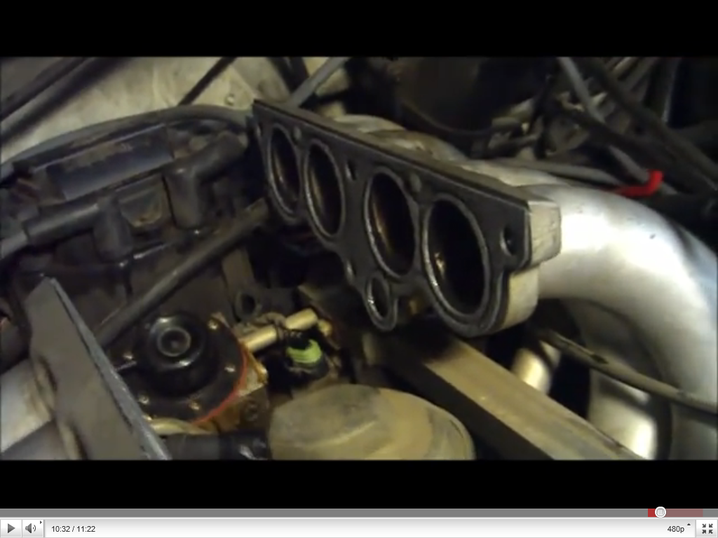

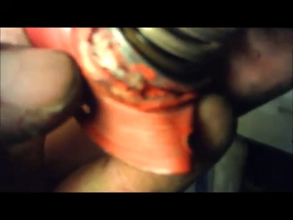

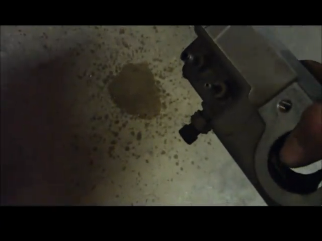

well i replaced it last night, it works
Attached Thumbnails gas in plenum brake booster?-456.png   gas in plenum brake booster?-4567.png   gas in plenum brake booster?-45678.png

LOL. Thanks for the props man. It makes feel all warm and fuzzy. I see you took a short cut on the lower runner gaskets. Its okay though. Im sure they're fine. You can pull the plenum without loosening the lower runner to manifold bolts. I just like to reseal everything while Im in there. Good job and happy motoring.
