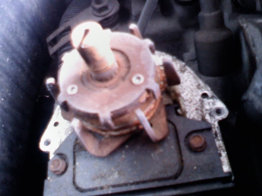

I got looking through my pictures that I have on may phone and I came across this one that I had taken of the dizzy last time I had the cap off. I have a feeling that this may confirm the idea that its my ignition system that is causing me the problem. Sorry the quality is a little bad.

I'd replace that, but then again, I enjoy spending money and bolting things to my car.
No really, go ahead and price a replacement.

Well thats the plan for this weekend. Probably tomorrow I am going to order a new dizzy, msd coil, wires, and E3 plugs for it. After that I'll have to see how it runs.
