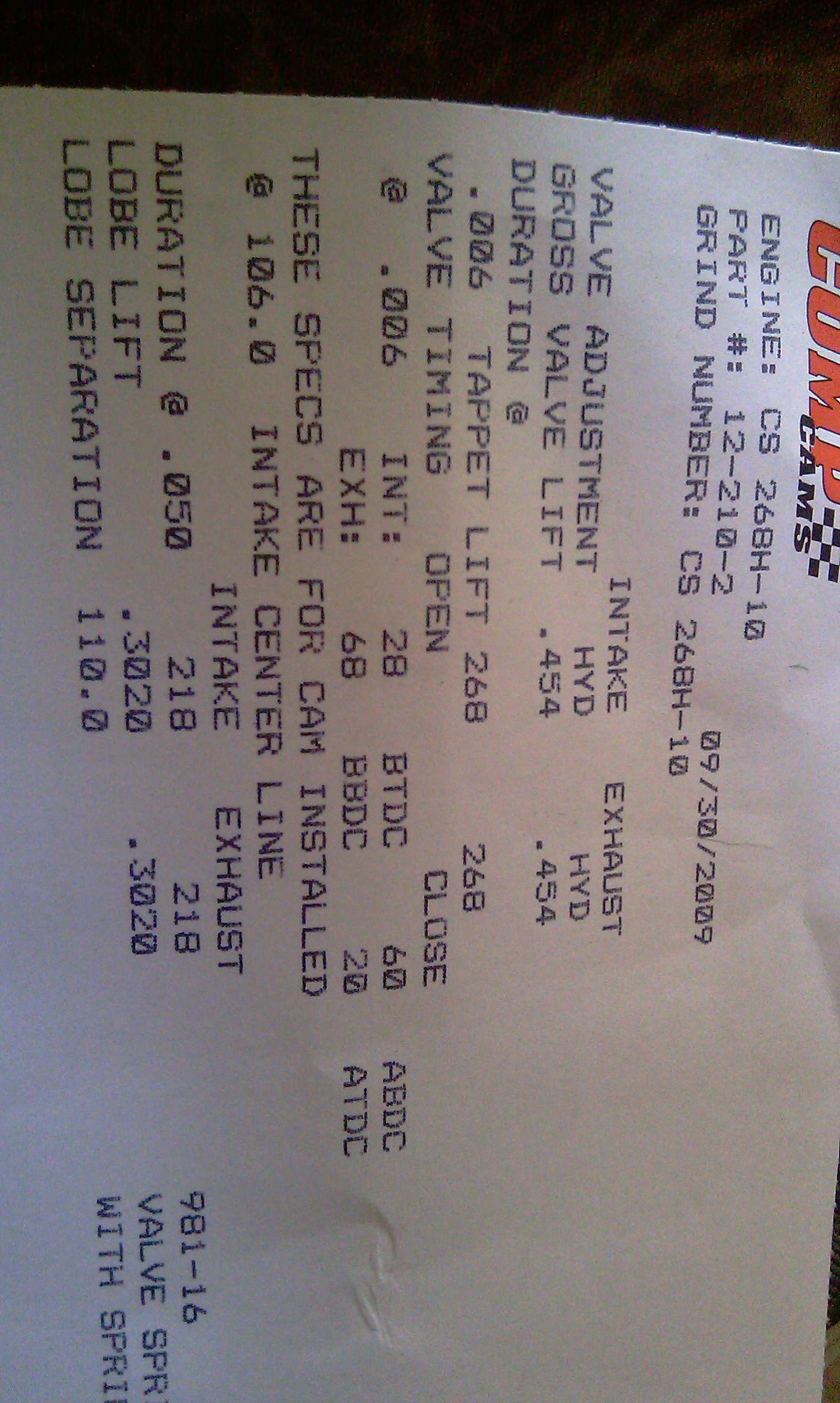

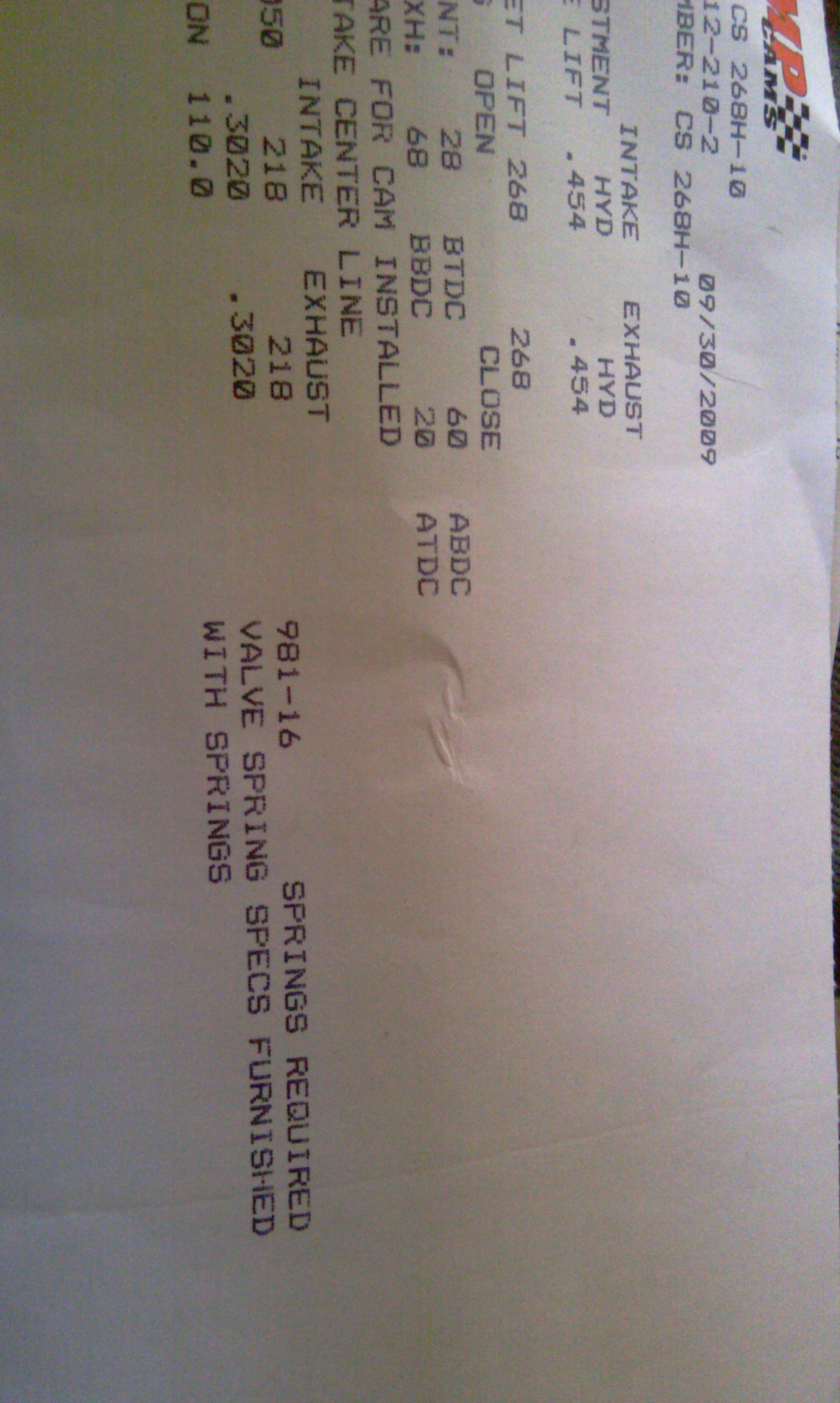

ok guys so my mechanic rebuilt my 350 and it won't start...:/...
he sais i get no compression...i get 60 our of 150...and the only way i get compression is that the rockers need 2 loosen them up...but then they r 2 loose...
i replaced the cam...(cam specs on the below)
do i need longer push rods or shorter push rods???...
he also said the piston rings my b backwards???...
plz help i really want my car back on the road...

Your best bet call Comp Cams ask them tell them what rockers you are using also

From looking at the cam spec sheet I would think Stock lenght but I would use a Push rod Checker just to make sure.
But if you use a aftermarket rocker arms some call out for diffrent lenght push rods.

You dont have a big cam I would Think stock should work but Give Comp Cams a call just to make sure.
Or you can go to there web site and look up your cam part Number and they should be able to tell you what push rods to use.

Sounds like the rockers are all too tight. (valves are getting held open 100% of the time)
Just back em all off 2 turns, and re-adjust em after you get it running.

i went on compcams.com and the recommend i put bigger push rods or thicker i believe and they also recommended roller rockers...
do u think that will help?...
I'm gona call compcams 2day 2 double check if i do need them...

Upgrading the push rods and rockers might possibly be "a good thing"; but that's not going to solve an assembly problem.
Just try backing the rockers off.
