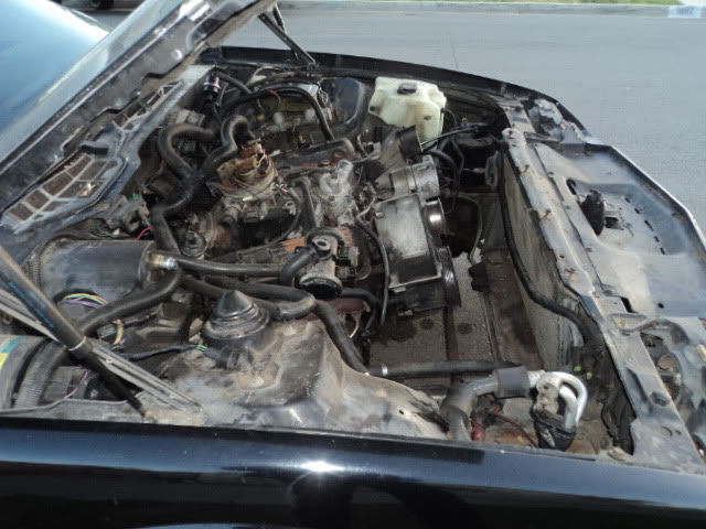

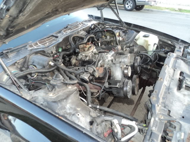

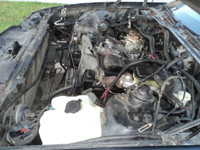

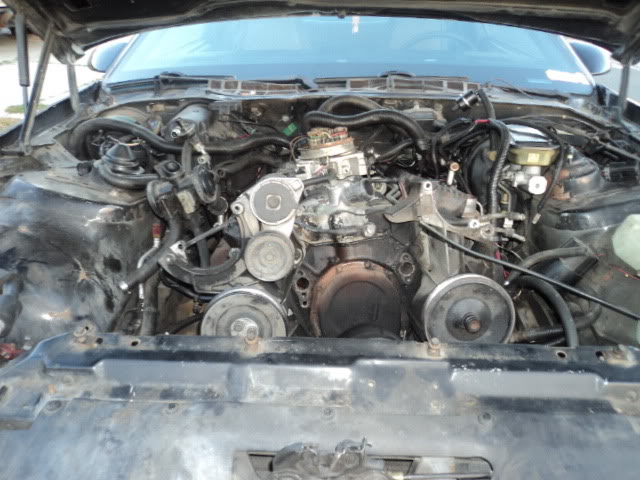

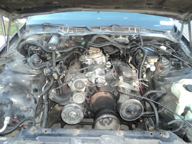

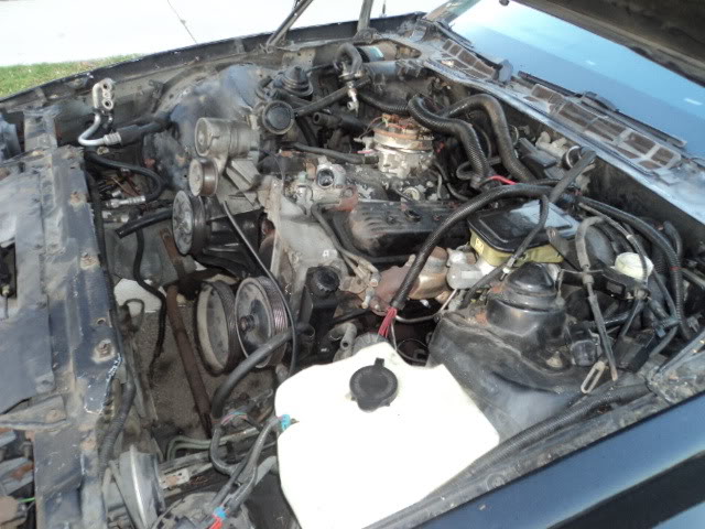

ok so i moved the car home and registered it under my name, in the end i got this girl for 500 dollers, what do you guys think?
all the parts that the car is missing is the distributor cap, and the radiator Fan, thats it

i just poped it in there to move it, now i will take it out and replace the gaskets

I see you've got the water pump removed... Might as well replace that while your at it
