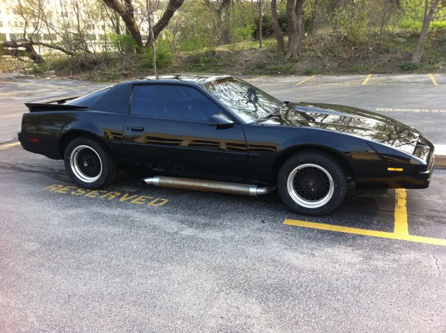

Hey Guys, new to the board, also included a pic of my '88 Formula 5.7 350
I have some issues. Lets start with the history of this car. I acquired it after it had been sitting for about 3 years. I was started up and run about once a month during this time but not driven much. The engine and trans were rebuilt about 5,000 miles ago and run very strong. I just had all the fluids flushed, new radiator, throttle body sensor. She gets up and moves once it is running, no check engine light. Here are the issues that have been plaguing me for the last month.
Cold start in the morning, starts up like a dream. Let the car run for any amount of time and she will not turn back over, let sit for 10 min nothing, let sit for 45 nothing, about after an hour it will turn again. Starter cranks hard but will not turn before that. I know that this is bad, but if I spray some throttle body cleaner in the throttle body she will turn right over and run fine. Fuel pressure is ok, new starter. Plugs, wires, injectors have been in there sitting for 3 years (as mentioned above) but I do not think that has anything to do with the issue.
Next this happened to me today and made me decide to post. Car stopped running and couldn't crank over at all at a red light. Think its the alternator or battery but they checked out ok. So, I got a jump box started to crank, nothing, sprayed cleaner, turned over and at every light i had to put it into Neutral and rev the engine so It wouldn't die. Battery gauge on the dash was at 13. Noticed from the previous owner that the terminals are jerry rigged, might have something to do with getting power to the car. Bigger alternator, battery, and fix terminals????/
Let me know what else you guys need to help me out. Frustrated that she is being a bitch but love the damn car. First third gen.
