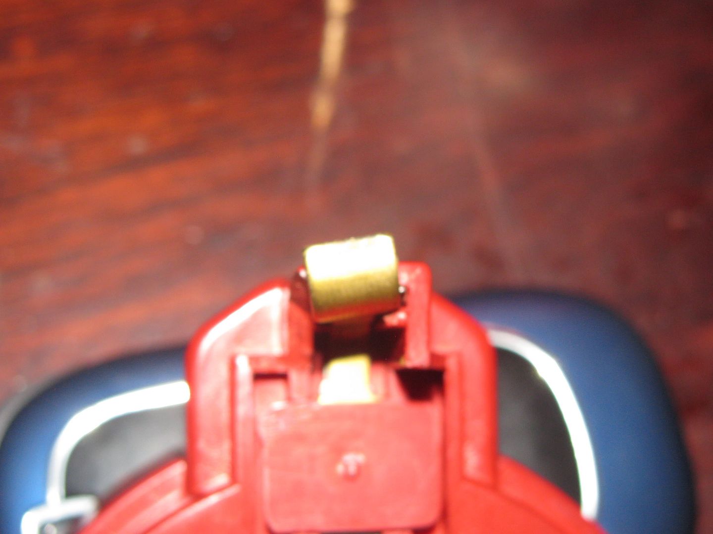

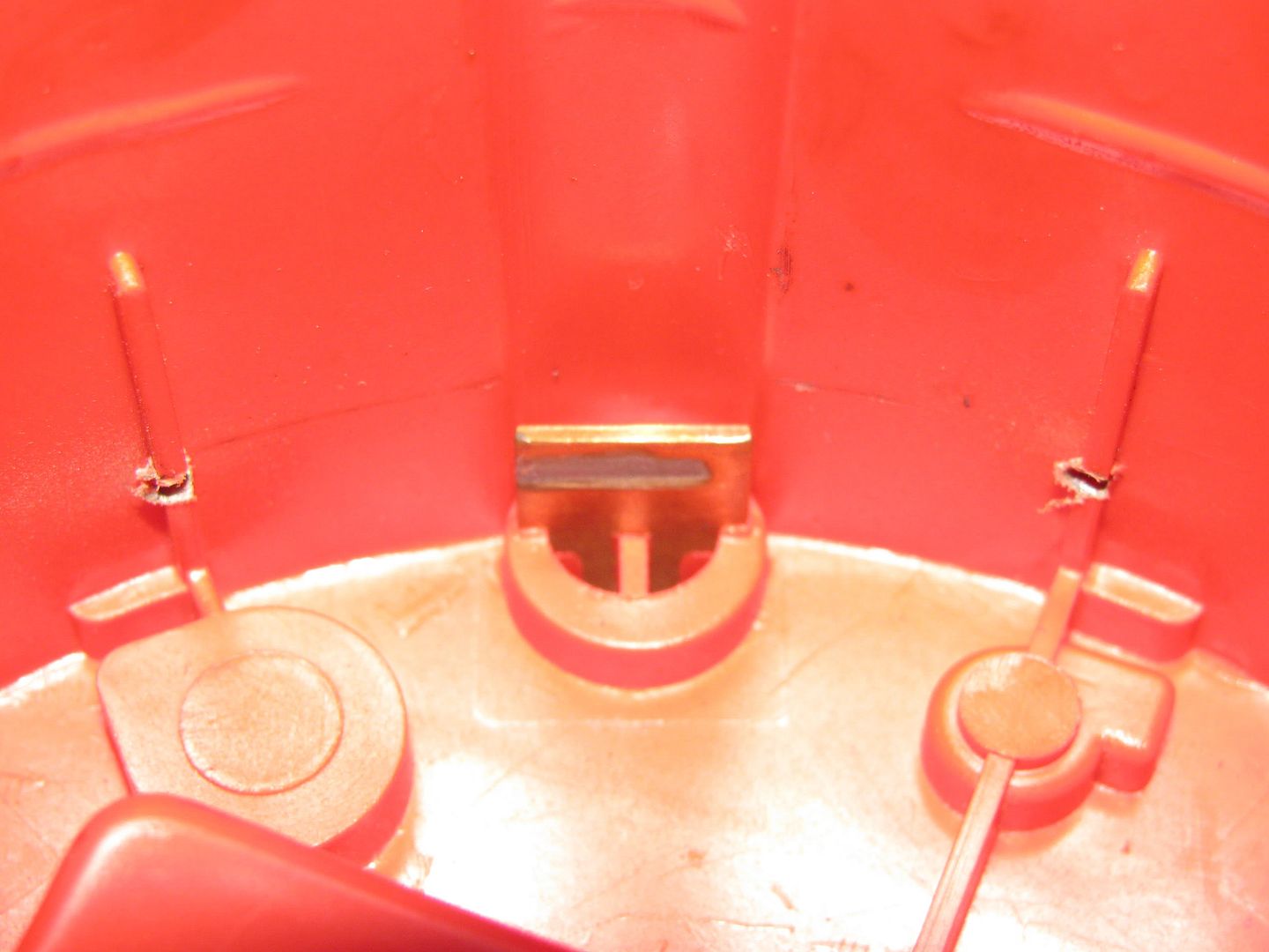

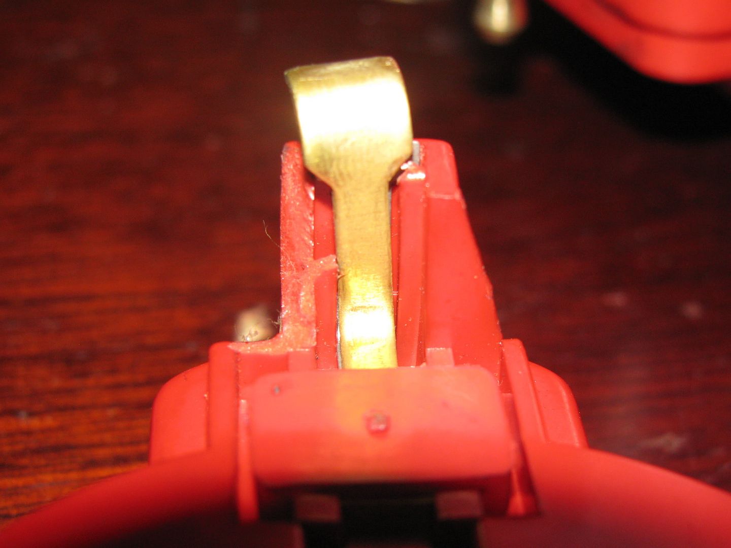

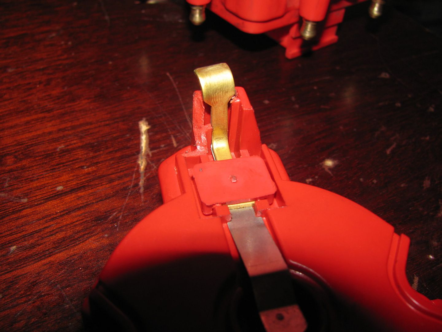

I just took my dizzy cap off for the first time since we put the engine together and noticed that the tip by the contact on the rotor is broken.
Take a look...
http://i99.photobucket.com/albums/l306/Zerocyde/012.jpg
http://i99.photobucket.com/albums/l306/Zerocyde/014.jpg
http://i99.photobucket.com/albums/l306/Zerocyde/015.jpg
http://i99.photobucket.com/albums/l306/Zerocyde/016.jpg
Could my problems have to do with this? The shuttering back and forth at low rpms, like trying to maintain a constant cruising speed, etc...
Old May 28, 2011 | 07:18 PM
//<86TA>\\'s Avatar
iTrader: (15)
Joined: Aug 2006
Posts: 12,812
Likes: 110
From: Central NJ
Car: 86 Trans Am
Engine: 408 stroker sbc
Transmission: TKO600
Re: Why would a car run perfectly smooth but gutless only when rockers are too lose?
looks like its cutting to the cap as well. thats defiantly a problem
Old May 28, 2011 | 07:26 PM
Zerocyde's Avatar
Joined: Apr 2009
Posts: 265
From: Spokane, Wa.
Car: 88 Camaro
Engine: 416 Stroker LS
Transmission: Magnum F
Axle/Gears: 4.11
Yea, all the contacts on the inside of the cap have that black mark on them. I'm heading down to the parts store now.
Old May 29, 2011 | 02:42 PM
Zerocyde's Avatar
Joined: Apr 2009
Posts: 265
From: Spokane, Wa.
Car: 88 Camaro
Axle/Gears: 4.11
That was the problem, it runs smooth as **** now. Well almost. I got a 4.5 power valve in from when I had 10 psi vacuum. Now, with the new rotor, I got 15 psi and need to put my 7.5 back in.
