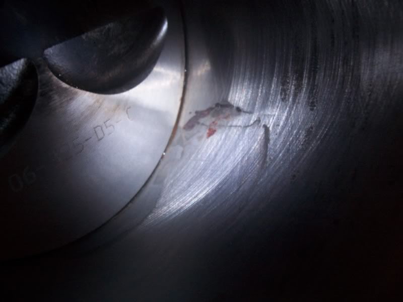

I had a 350 block before this one that had to be bored .060 over. Got it bored, honed, and put together and this happened after the first time I took it around the block:
I will never touch another .060 over block again. Also, my block is .030 over, it's 355 cubic inches. That .060 over block was 360 cubic inches. Is an extra 4-5 cubic inches worth potentially reducing the integrity of your cylinder walls? If you got a perfectly matched, efficient streetable combination, which you dont seem to care about getting since you seem to be planning on just throwing the biggest cam you can fit into it, you'd lose at most 1hp and 1tq per cubic inch. Throw a K&N filter or set up a fresh air intake from cool outside air and you'll get more hp benefit than that. A good tune up will get you that much probably.
