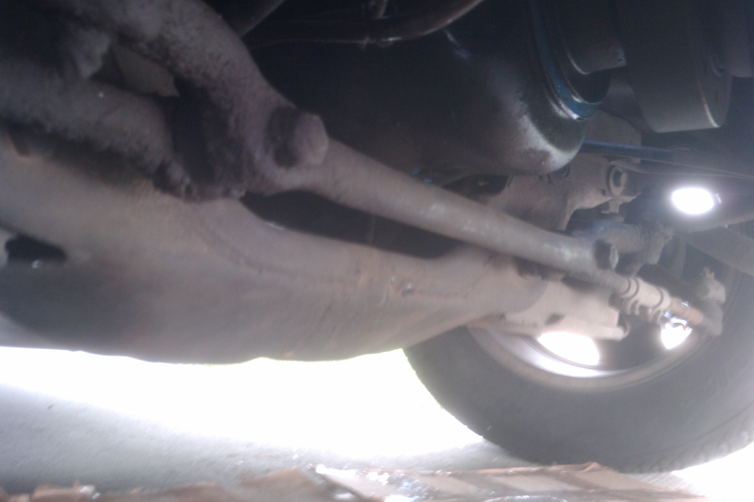

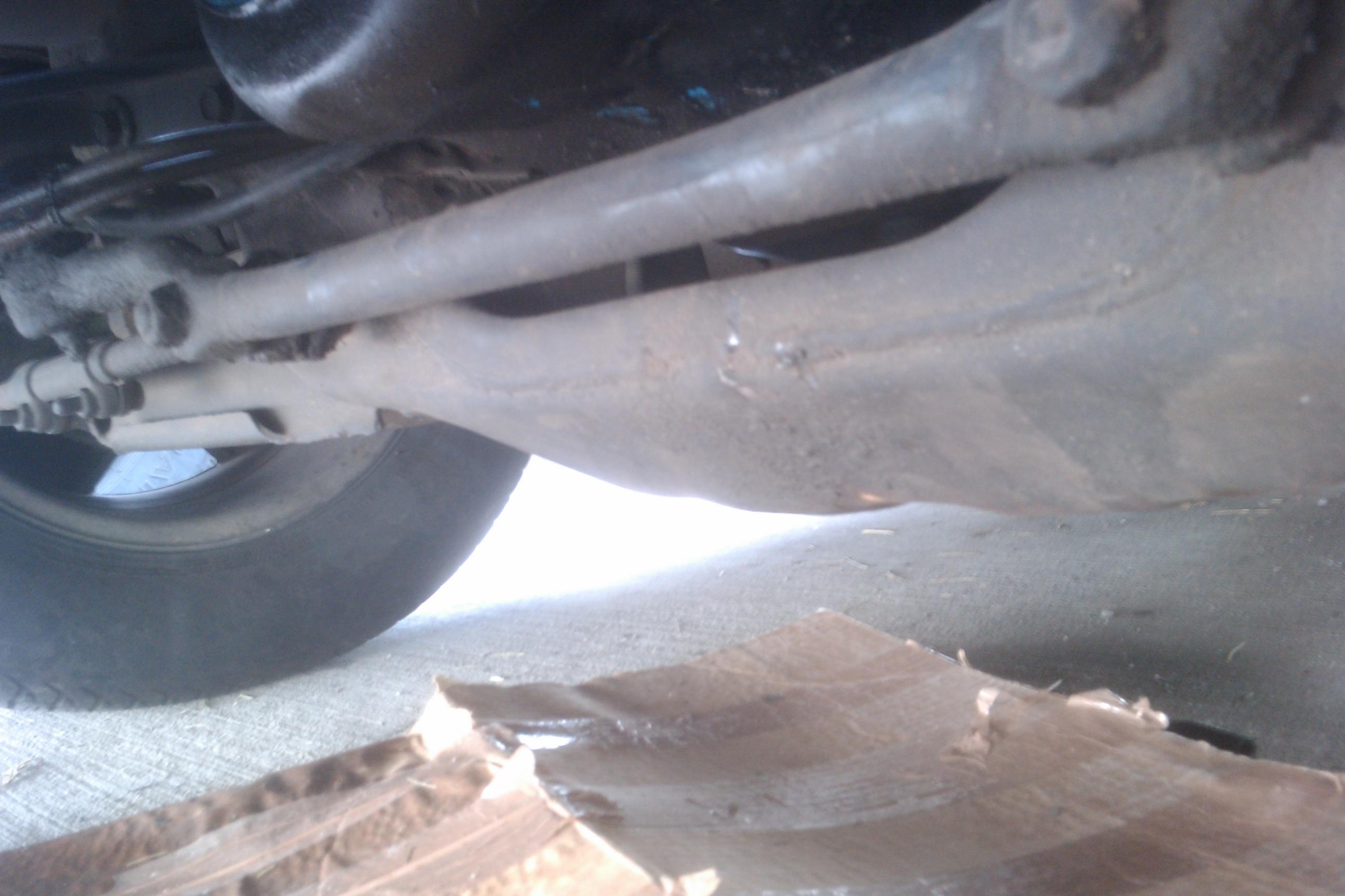

here are pics of my oil pan, and a video of it running.
http://www.youtube.com/watch?v=C-MunUFyMxI
I'm thinking it must be the crankshaft banging off the pan. Would this likely have done internal damage? how easy is it to swap the pan without pulling the engine?
any advice would be great thanks.
Attached Thumbnails Oops... need advice please-imag0025.jpg   Oops... need advice please-imag0023.jpg

shouldnt be enought to cause all that ruckaus mine has a desent dent in the oil pan but doesnt make any noise ,bu.t if you belive its the pan
oil pan removal

Hate to be the bearer of bad news but that dosnt sound like the crank hitting the pan nor a bad detonation. It it was hitting the pan you would be able to see the pan moving and you could feel it clearly if you touched the pan. Detonation sounds like a pinging. That sounds like your bottom end is in serious trouble. Is it a used motor or a fresh rebuild?

Before I hit the oil pan with the jack it sounded fine. Could I have really done serious damage to the bottom end when I dented the pan?
Either way I bought a new oil pan and i'm planning on putting it on tommorow. I guess I'll find out then.

instrested to see what you found out there was it the oil pan. My guess would be oil pan. Or the rare case of just bad luck cause it wasnt making the noise before. There isnt alot of clearance between oil pan and crank.

Well, I changed the oil pan out today and that was definatly the problem. Sound is gone
