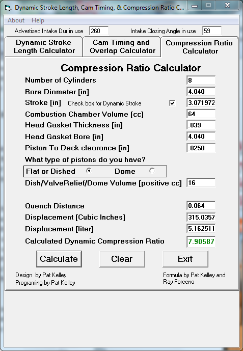

So 'm hoping for some advice/help. I put together a nice 383 combo, Eagle forged rotating assemble aprox 9.43 Static CR, 7.90 dynamic CR. It's got a RPM intake, Edelbrock Etec 170's 454 Tbody bored to 54mm, EBL, Comp 260XFI cam, 1:6 Comp Gold Magnum Rockers, Stainless Headers, Open element air cleaner ect.... I'm getting alot of knock counts , I can't hear ping or what not because the engine and exhaust are so loud. I've looked at the plugs and don't see any residue from the pistons which is a good thing. I've used a really conservative spark map, double checked base timing. I went and bought a gallon of Torco race mix and mixed it with 20 gallons of 93 pump gas giving me around 110 octane. Still getting counts however less. I get counts when revving in neutral which leads me to think the cam at 59IVC@.006 I gulping to much air which I have read that DCR is a number however intake flow effects that also and it breathes very well. Once again advice/help would be greatly appreciated. This build is similar to a ZZ383 that runs 9.6 static cr and recommends 92octane. Any other things I should consider I don't think the plugs are to hot they look good.

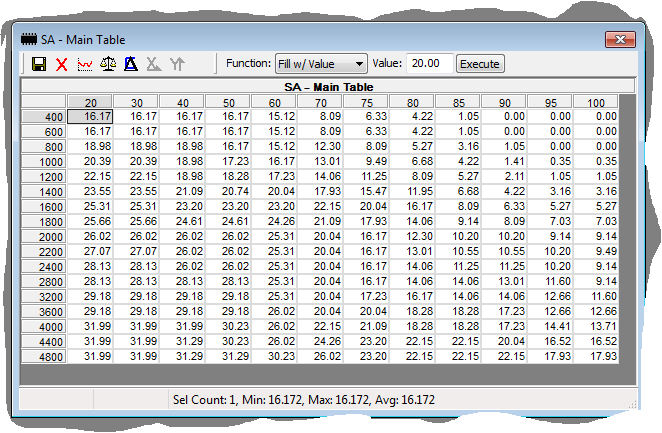

Here's some screenshots to help out.

I used Pat Kelley's DCR calculator and my quench should be .064 based on a .0250 piston to deck clearance and .039 head gasket. I'm trying to post the images from photobucket however it's not working out I'm trying to figure that now.

That is a very good read with extremely useful information. I just got back lowered spark map to 18 degrees total everywhere above 1600rpm even went to 12 degrees after that and same thing on the Torco gas the problem is I can't hear any knock or ping because like I said before the engine is to loud, forged pistons are a lot louder than hyper's. Anyway one again great read and if anyone else reads this post check out the above link.
I also checked the compression again and it's 162 this time which should be ok for pump gas. Here's a 10 minute run and the knock counts captured. I hope I'm not chasing gremlins I really doubt it though because I can trigger the knock by holding the brake while driving and having it in PE watching Wideband (12.5) and push the pedal a bit and ding knock count- so it seem with rpms increasing rapidly cylinder pressure increases with exhaust scavenging big gulp of air to much DCR, or like a read in that link a quench problem.Name:  knockat18degrees.png

So I finally got it back from tranny shop Friday. I ran the torco mix out and put premium back in. I also went ahead and put the normal spark table back, I'll attach an image. Of course I'm still getting counts, even though I can't hear anything. So one thing I noticed today is that when free revving engine if I raise the throttle/rpms slowly I get no knock, If I blip throttle or fast rev I get all kinds of count / retard. So this may actually be a tuning issue, perhaps. Any more suggestions before I head over to the tune forum? Name:  SaHighSpark.png
