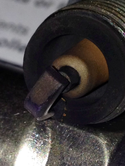

Heres what the engine is looking like. I am pretty happy with it considering the before pictures earlier in the thread. But I do have a question for you guys. Does the porcelin of this plug show signs of detonation to you? I'm getting the detonation sound but not like I have ever heard before. Only at 2800rpm and up. Pretty much unrelated to load. 100 octane made no difference. Retarding the timing all the way till it fell on its face made no difference. This is leading me to think it is actually the tranny since it does sound like its coming through the shift boot anyway. 11.06:1 c/r.... and there is NO WAY it should be lean since the demon 750 has massive 82/88 jets in it. I am going to slim those down as I make sure everything else is good. I know the timing is up there but i read guys running higher, and my quench was right at .040"

That sounds like a mechanical issue if its load independant. Likely something in the trans, or maybe flywheel related. Possible its also the engine as well.
Does it do it in neutral, all gears, only just one gear? Where does the sound come from? Might want to run it on a lift so you can isolate the source of the noise.

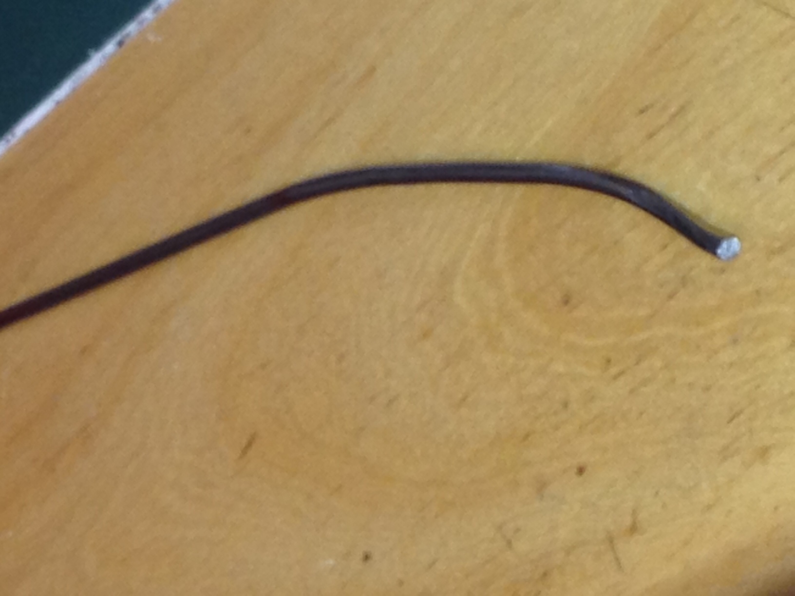

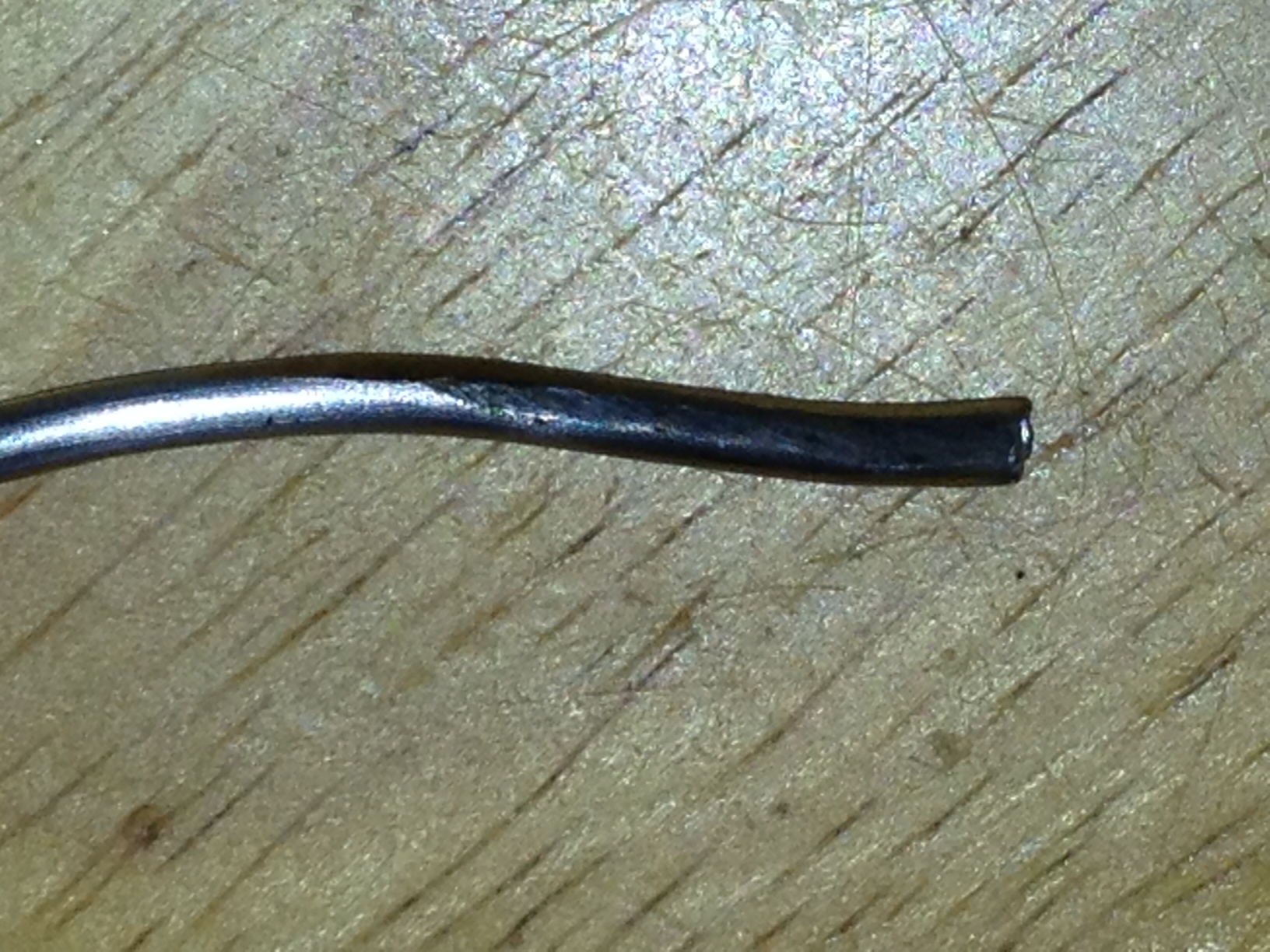

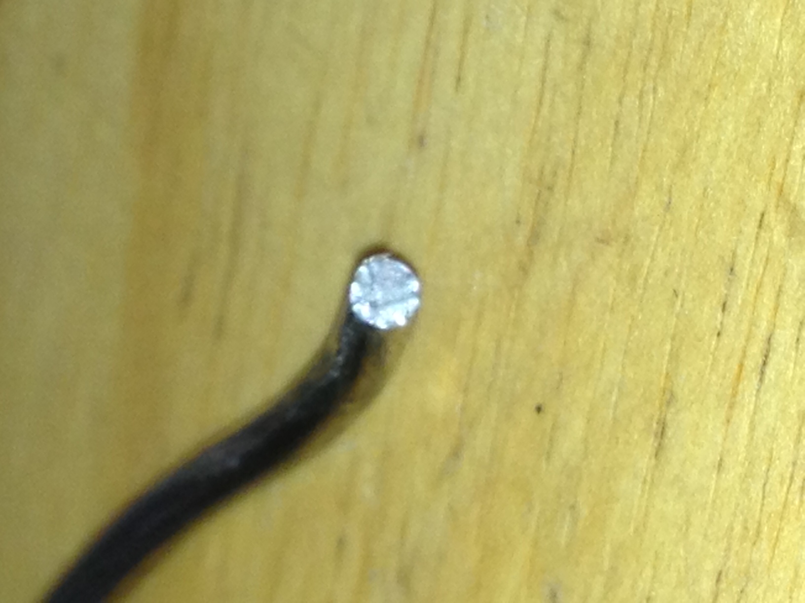

I attached a couple pics of the dipstick. The thing isn't really flexible. It is much like a piece of welding rod. Malleable, but will hold its shape. I have a stock type in there now. On the stick you can see where the crank/rod/whatever was smacking it at a very slight angle, then a fairly clean break. Kind of resembles a cast piece that was broken. Slightly rough.
