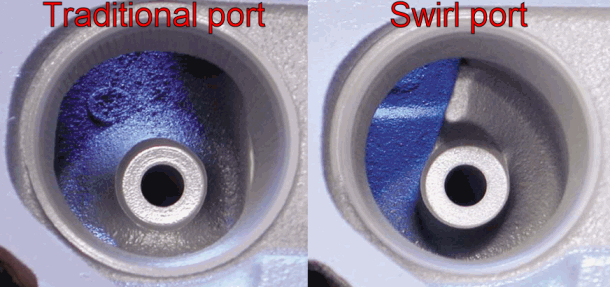

When people say Vortec heads, tehy mean the 350 heads from 96-98. Every truck engine after 96 got "Vortec" badges, but it's one of those little differences. Kind of like how we call 98+ Camaro brakes "LS1 Brakes". The brakes have nothing to do with the LS1, but they emerged at the same time and it was a notable difference in that year model. So that's why you can get "LS1 brake" upgrades.
Now a lot of unscrupulous a-holes lie to people and call all truck engines from like 1985 on or whatever, to the present, "vortec" engines since the 350 5.7 heads called "Vortec" are desirable and it's hard to tell the difference between a 1990 350 and a 1998 350 if you dont know what to look for.
There's aways "Vortec" stuff on ebay that aint, and then I keep seeing this term "pre-Vortec" thrown around on there too, as if Vortec stuff were around before they got the label. But 193 heads are junk(below mediocre for horsepower anyway, they're great for a towing rig or 4x4 setup I bet) swirl-port heads, and 906 and 062 heads are better than even the best factory LT1 heads. There's a HUGE difference, but it's not obvious which are which unless you are looking for casting numbers.
So in short, you got hosed because you didnt know what to look for, and this ******* took advantage of your lack of knowledge about what you wanted.
Second engine down is what you have, and where this description is from:
http://www.strokerengine.com/MrGoodwrench.html
CASTING NUMBER 14102193 SWIRL PORT INTAKE PORT DESIGN 65.3cc COMBUSTION CHAMBER
THIS HIGH SWIRL HEAD CYLINDER HEAD IS NOT A PERFORMANCE ORIENTED CYLINDER HEAD. IT IS INTENDED FOR GOOD BOTTOM END TORQUE AND FUEL ECONOMY. THE INTAKE RUNNER IS RESTRICTIVE BECAUSE IT HAS A RAMP CAST INTO THE BOTTOM OF THE BOWL TO PROMOTE HIGH SWIRL.
The magic with real vortecs is that GM had some bright engineers working on the LT1 program (allegedly some "NASCAR" guys... but I take that with a grain of salt) and they wrapped the LT1 head design phase and had an extra 6 months to work on the truck heads. Understand the trucks were the only Gen I sbc's around anymore at that point, but the Lt1 Gen II stuff and the Gen I stuff are similar as far as port design is concerned. So they came up with some clever trick to promote swirl (which increases efficiency - that's good for fuel economy and horsepower) without building this huge ramp into the middle of the port. So they got good swirl characteristics AND they got good airflow. More than that, they used chambers very similar to the LT1. They're the best combustion chamber you can get on a factory Gen I head.
The swirl port heads got the same basic chamber every other head got in the 80s.
https://www.thirdgen.org/forums/tbi/...heads-why.html
And here is a comparison of regular chambers, and the vortec chambers:
