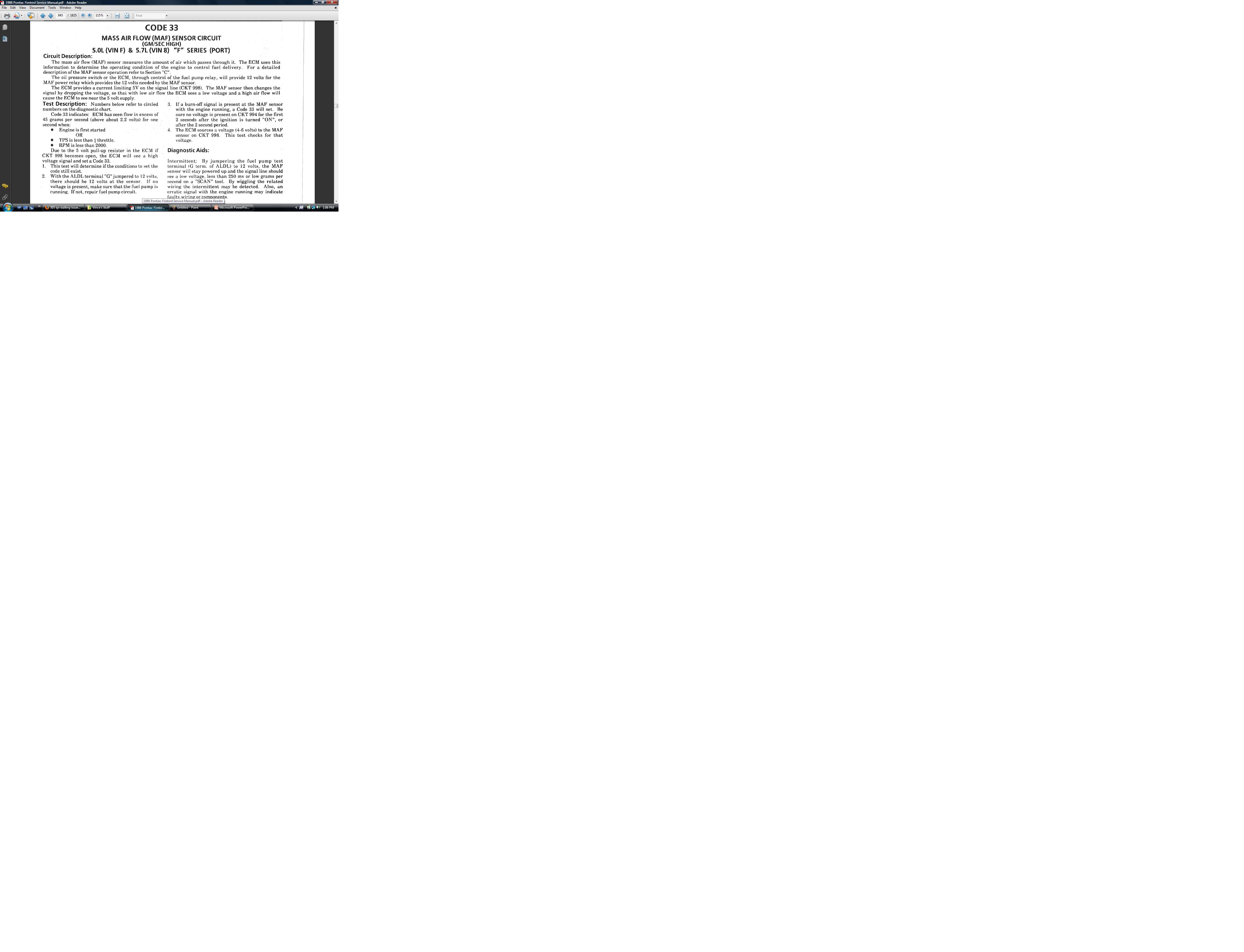

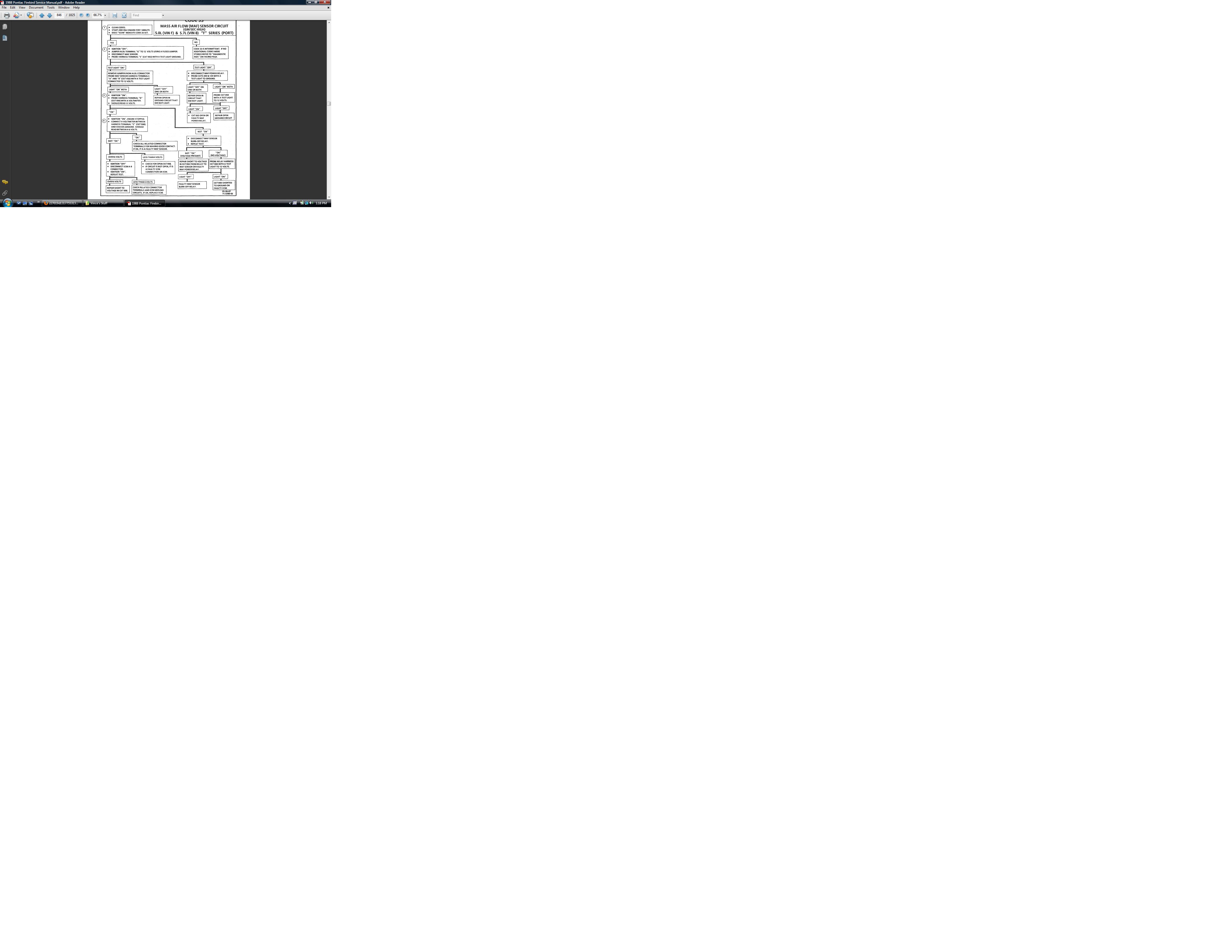

Hello,
Check your TPS by measuring the voltage between the top two wires on the TPS connector (A and B, I think). It should be 0.54v at idle and it should move smoothly up the scale as the throttle is gently increased. You can partially remove the rear cover of the TPS connector and place the multimeter probes in the back of the weather-pak connector.
Sometimes injectors can ohm-out okay, but still be leaking.
Code 33 has something to do with the TPS as well...read over the attachment.
Hope this helps.
