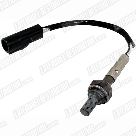

This isnt the same o2 sensor, but the end of the wire needs to have a connection like this on it.
I would think you could either try to find a connector off another o2 sensor or just buy a new sensor, to keep it a simple fix They can range in prices as cheep as 25 bucks
Dont pay attention to the amount of wires or the design of that picture, i just want ya to see what sort of connection your missing.

ok, yea i found where it is supposed to go into easily, now its just a thing of buying a new one. would the sensor make it so my gets a weird exaust smell inside the car. it has always happened since my brother had it and its not bad but im just wondering if this was why.

It could very possibly give you an exhaust smell inside the car. Otherwise start looking for a hole in your exhaust.
O2 sensors are cheap, and besides the broken wire, its likely shot anyway. Just replace it.
