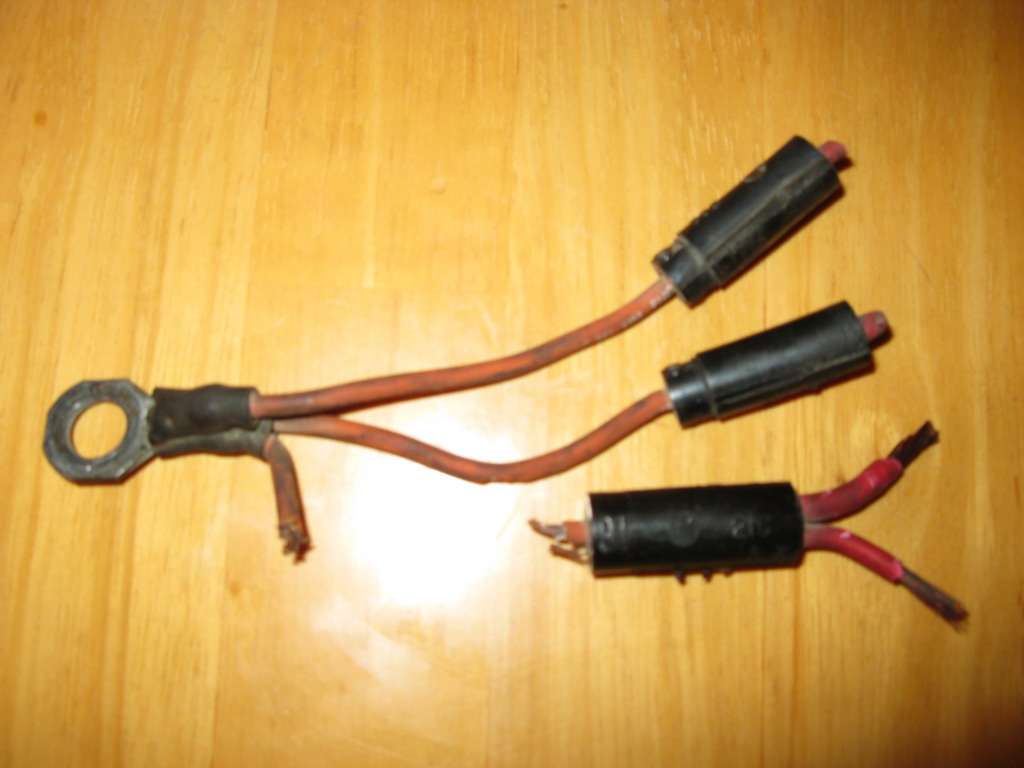

lining up the rotor is part of the "verify timing" and its a piece of cake. all you have to do is take out the #1 spark plug. stick a finger in the hole and have someone turn the engine over until you feel pressure, then line up the timing mark to 0*. where ever the rotor points in the cap is the #1 wire. then you can set the timing to where it needs to be with a timing light.
the fusable links are black plastic looking things on the wires that bolt to the starter. theyre ment to seperate and stop current to important things if the amp load gets to high, just like a fuse. they look like this:

they arent actual fuses in the sense you can just un plug and replace them. you have to buy a new section of wire with a fusable link and splice that in, or just use straight wire and do away with them.
