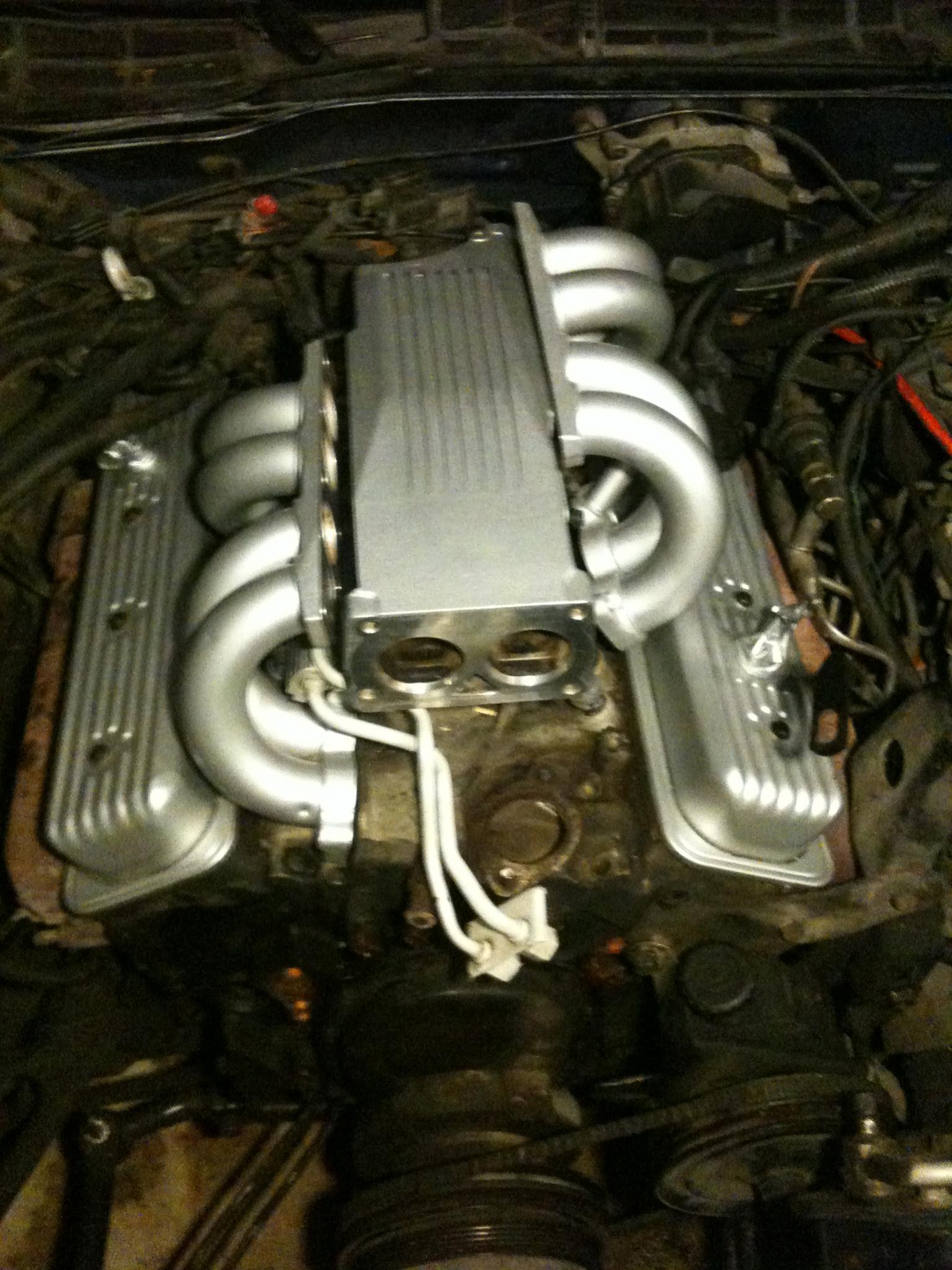

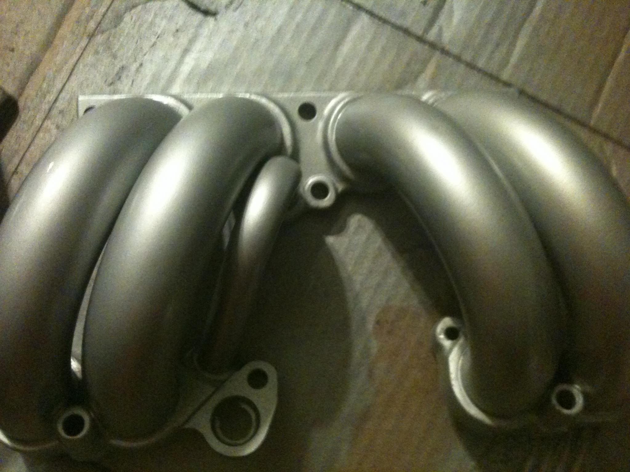

well i went with the paint i am still waiting on the intake but got gaskets today so i did the valve covers. i painted everything else as well. hope the intake gets here soon this car is my everyday driver so i need it on the road quick!lol

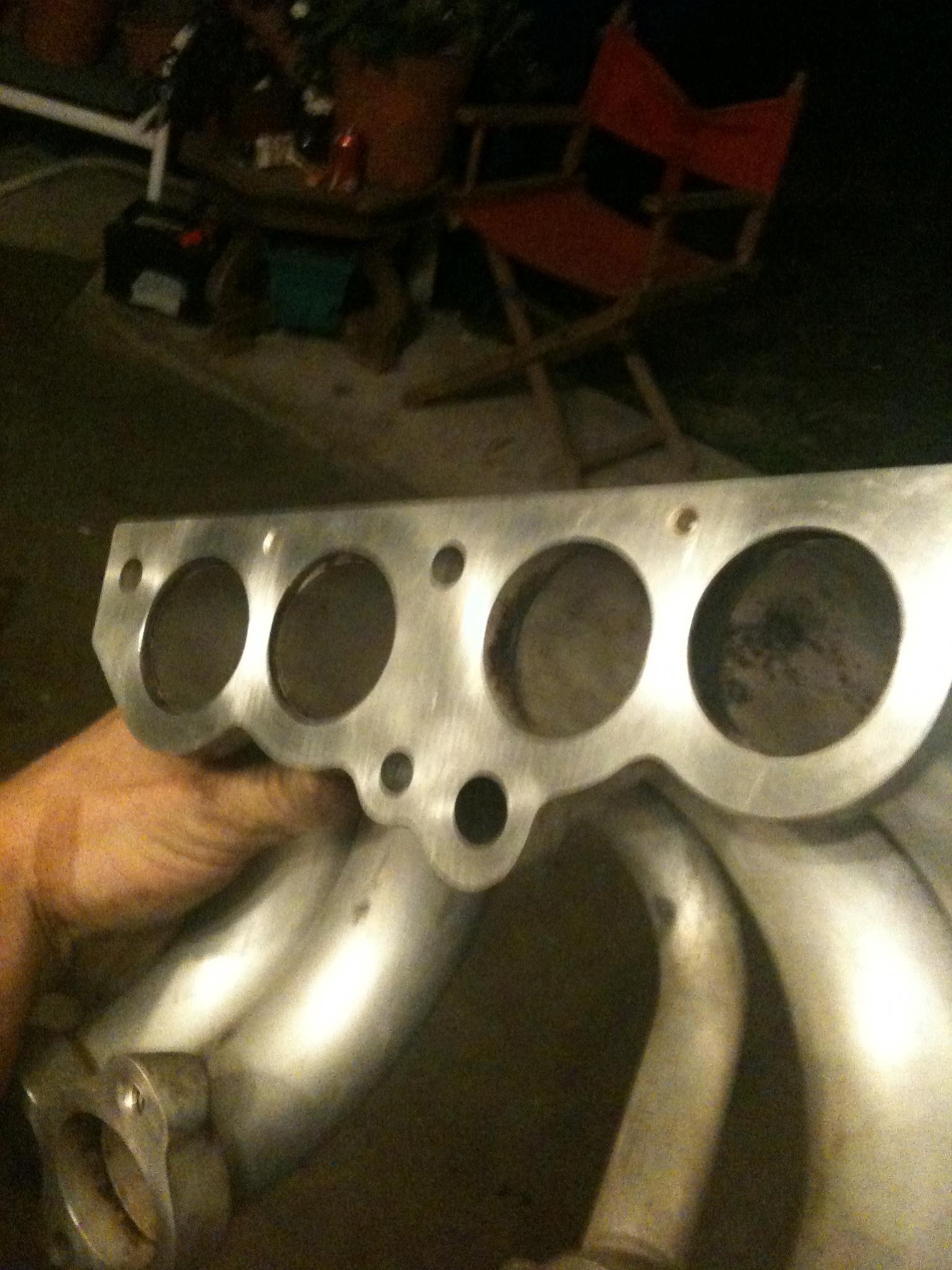

few more. last one is just for fun

Old Dec 12, 2011 | 07:19 PM

Re: little help with intake
the insides do to. what a pain in the ***. but yeah thanks i cant wait to see it bolted together.
