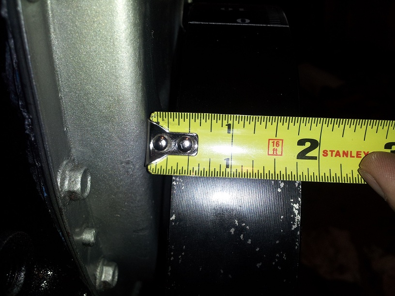

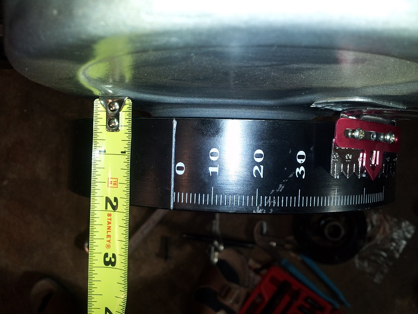

I'm trying to put my new 8" harmonic balancer on my new shortblock. It seems to go on a little but then stops and I can't turn the installer nut anymore. I'm not an mechanic but I think it should go on further?
I've tried putting assembly lube and high-temp grease on the inside of the balancer & the end of the crank but it doesn't seem to help.
Attached are pics.
Any advice would be greatly appreciated!
Thanks!
Attached Thumbnails Balancer trouble.  Please help!-balancer1.jpg   Balancer trouble.  Please help!-balancer2.jpg

Yes it should go on quite a bit farther; it hasn't even contacted the seal yet in the pic.
Aftermarket balancers frequently require honing to match the crank. Use a brake cyl hone with some sandpaper wrapped around it; about 120 - 180 grit, lubed with some ATF. Hone it until it goes on up to about the point where it is now or just a bit farther, by hand.

That balancer lacks about ¾" or a little more, of being on all the way, at the moment.
There is no question whatsoever that it isn't right.
It should end up going on such that the back of it is within ¼" of the timing cover or less.

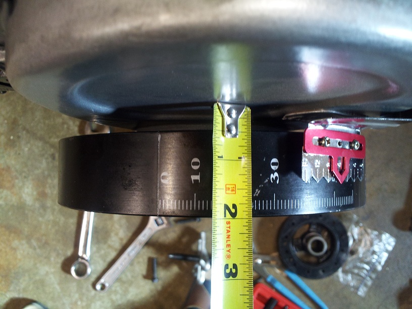

Well guys, I feel really dumb. I tried honing, heating, sanding, etc and nothing worked.
Then I noticed, when I was using my installer tool, it was wobbling just a bit when I screwed it in. So I decided to rule-out the tool, went to Autozone and got a rental. WITHIN 5 MINUTES I had the thing on!!!
Ugh. I wasted a Saturday trying to install a balancer
I guess the lesson learned that I can pass on is - don't assume your tools are ok. My installer was a name-brand that I got a few years ago from Summit, I barely used it, and apparently its messed up already.
Attached are new pics. The balancer is pretty far back and I don't know if I feel comfortable torquing it back any farther as it is pretty tight to turn. Does this look ok?
Attached Thumbnails Balancer trouble.  Please help!-balanceron1.jpg   Balancer trouble.  Please help!-balanceron2.jpg
Old Dec 18, 2011 | 11:08 AM
Posts: 27,893
Likes: 2,436
Re: Balancer trouble. Please help!
OK, you may now spank yourself for that.
OK, enough... you're starting to enjoy it too much.
Looks like it might need to go on a bit more... try taking it off (not necessarily all the way, just until it gets somewhat loose) and put it back on, one more time. Use a longer wrench on the bolt. As you tighten it, the torque will go up steadily, then suddenly shoot up radically when it's all the way on. Keep tightening it, no matter how tight it seems to be getting, until it reaches that "knee" in the curve, indicated by a SUDDEN rapid increase in the torque; that's when it's bottomed. As long as the torque keeps increasing GRADUALLY, keep tightening.
I pulled it forward a bit and then started tightening again. It did gradually get tighter and is now bottomed out. It's roughly 1/4" out from the curved part of the timing cover. Is this ok or should i pull it off and try again?
Old Dec 18, 2011 | 01:54 PM
Posts: 27,893
Likes: 2,436
Looks MUCH better. Should be good to go.
