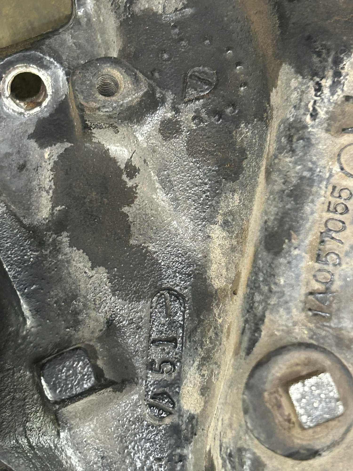

Old Aug 5, 2025 | 03:02 PM
Jessie D's Avatar
Joined: Aug 2025
Posts: 1
Re: "055" intake manifold
Can someone tell me the make/model/yr of this intake manifold? Trying to find the foundry. Thanks
