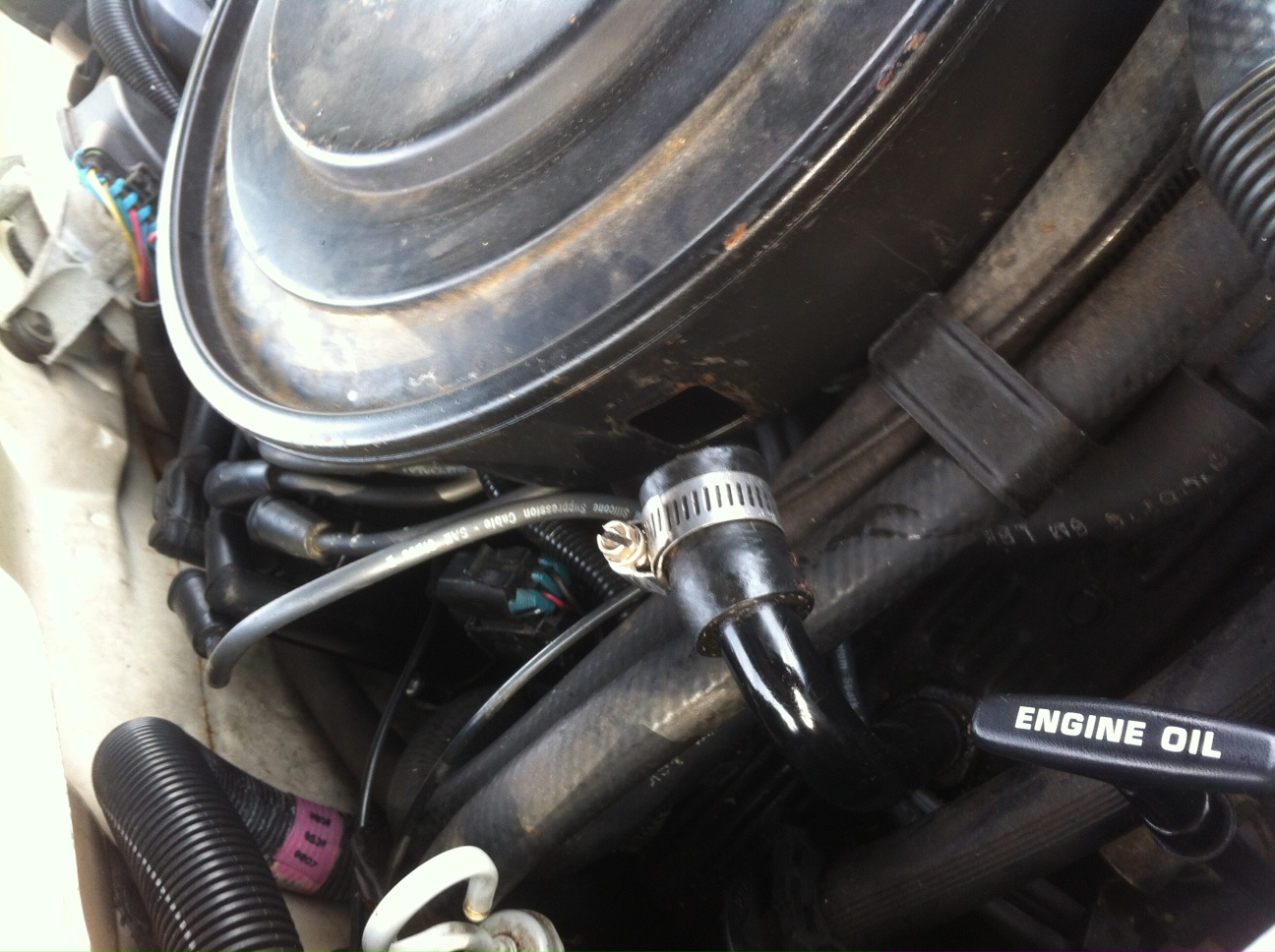

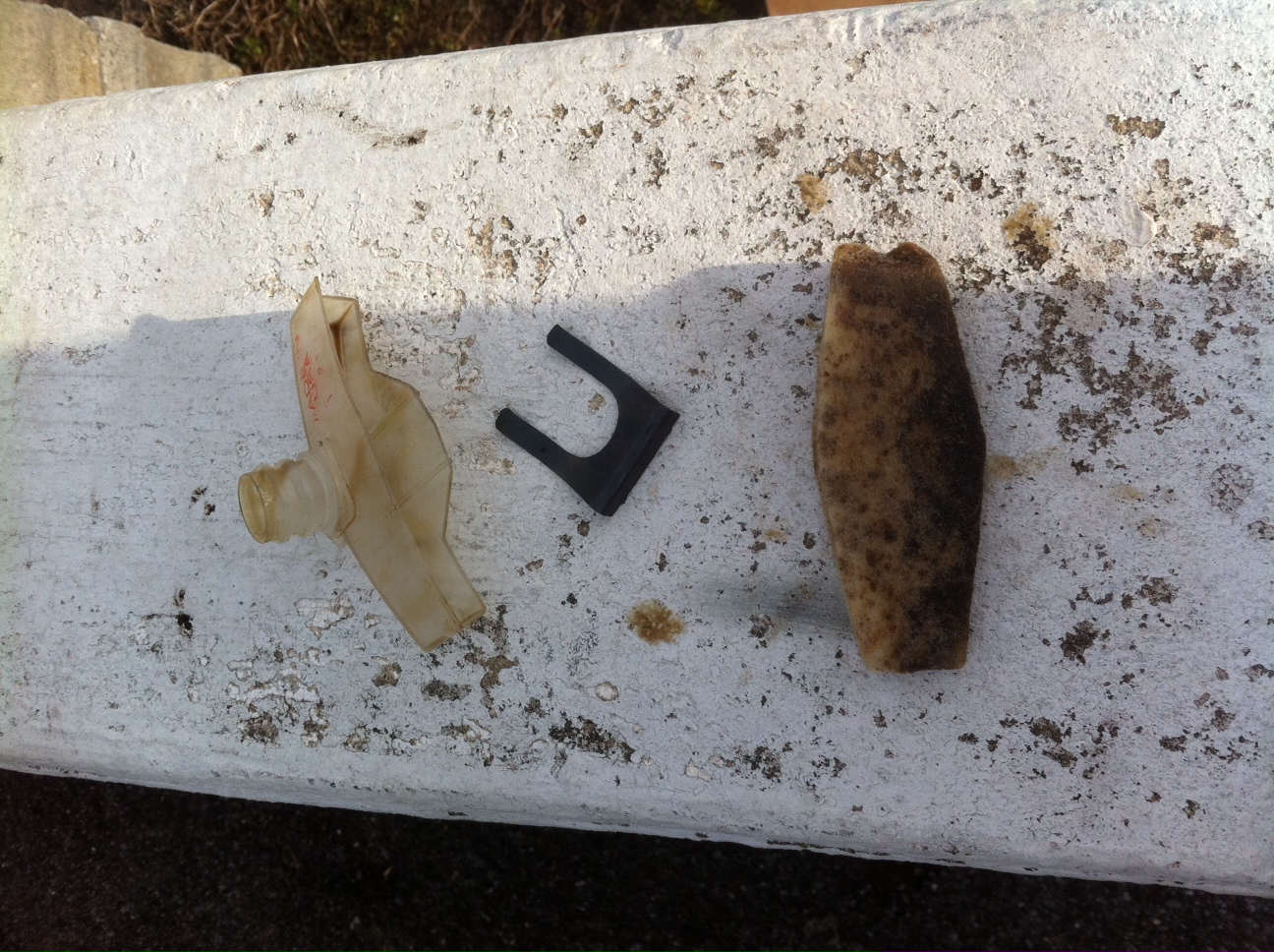

SO here is the situation.... I placed a new flexible metal ducting (goes from underneath the snorkel to the exhaust manifold) because it was ripped. Car seemed to be running better. Drove to work the next night (Cold in PA) and after about 15 mins, the oil pressure gauge dropped to about 12 or 13 pounds. At the same time, the coolant temp shot up to 260. I immediately pulled over, checked everything, seemed fine. Took the piece off, turned the car on and immediately everything went back to being fine. Drove home and no problems. Checked fluids today and Oil level was perfectly where it should be but it had little black flakes in it. The coolant level was fine too! Taking off the top plate of air cleaner housing, the PCV filter was covered in oil!! Looking inside the rubber hose attached to the filter, I find engine oil AND coolant mixed together pooled right before the down turn!!!!!!!! Anyone have any idea where to begin?!?!

I looked at your two photos and I don't see any coolant or flakes in the oil. All I see is a dirty breather filter, which is normal.
