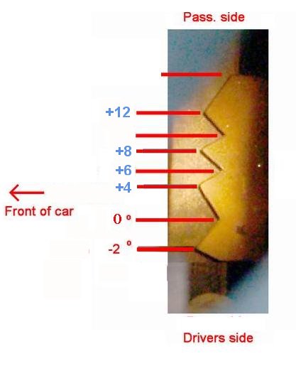

Ok, I found my timing light. I disconnected the one wire connector and checked the timing. The scale on the block goes to 12* And the timing mark was probably 2-3 degrees above that. So it was somewhere around 14 or 15 degrees base timing. So I set it back to 6 degrees.
look at the attachment. You said you did disconnect the EST (brown wire/black strip) near the blower motor? Then reset your ecm by disconnecting negative battery cable for a few minutes?

In the pic, where the red line is that's above +12. Thats about where the timing mark was. And yea the EST. I couldn't remember what it was called. I haven't disconnected the batt. yet But I'm getting ready to do that. I did rev her up a few times and there seemed to be no hesitation. But I'm going to drive to the gas station about 2 miles down the road and see if the hard acceleration hesitation is gone.
that would be 14. Disconnect neg. battery cable first and then take her up to the gas station.
